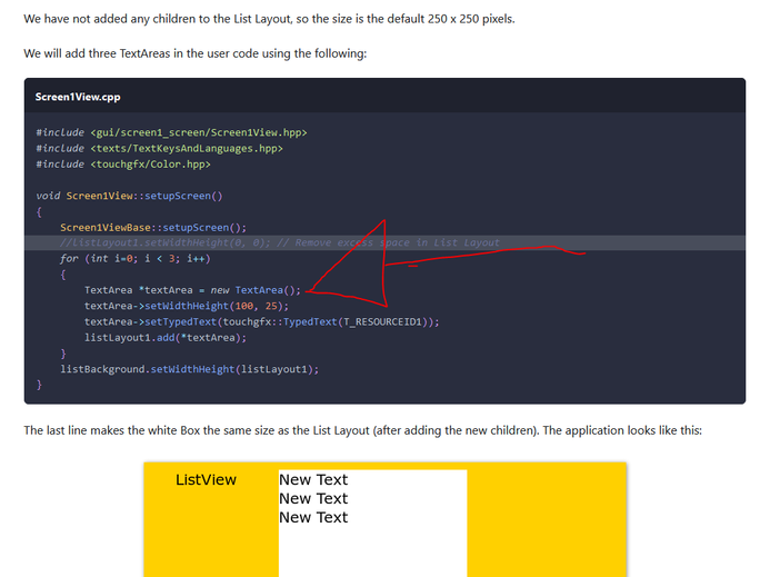

Hi Gfx Team,
Could you comment on this please ?
I tried to View.add () heap allocated container and it seems to be working Okay.
The container might be statically allocated as well. The key point is, the View is not aware of it at compile time.
Before Transition to other screen, I remove the widget from the View and delete it.
void ScreenView::tearDownScreen ()
	if ( nullptr != pWgt )
		remove ( * pWgt );
		delete pWgt; // heap allocated
		pWgt = nullptr;
	ScreenView::tearDownScreen ();

Yes, Osman gave a simpler answer, basically "You shouldn't do it" for more beginner level. I answered "It is possible but should be avoided" which is also a simplification because precautions should be taken (c.f. below).
The full answer is : It is possible to add widgets or elements at runtime but due to the limited amount of memory in embedded devices, precautions have to be taken such as allocating a specific memory region for the dynamically added widgets and only adding widgets at runtime in this region plus it is recommended to limit the amount of widget and to reuse the ones that are not visible instead of creating a lot of different widgets.
"STemWin"
Sure, I thought that you said STemWin was able to dynamically allocate memory, create widgets and clear them when they are not visible anymore.
In a way STemWin and TouchGFX work in the same way. You could add widgets at runtime in both but you have to do it smartly.
Are you creating widgets at runtime in your STemWin applications? If you do, what safety measures do you take?
How to properly add widgets at runtime
1) Using new
Create the widget using new.
Add the widget to the screen using add.
Don't forget to clean it in tearDownScreen(), for that you have to store your new widgets in a vector.
This method has no verification so your program can crash.

GaetanGodart
Hello @ferro ,
In my post, I think I also mention that it is not recommended to add widgets at runtime because in embedded devices, memory is limited.
It is possible to add widgets at runtime. c.f. the example I give.
It crashes after adding over 1000 widgets so that is probably the risks you talk about.
Overall, you should know how many widgets you need at compile time.
I don't know what are the risks with adding widgets at runtime in TouchGFX because this is never recommended.
I can try to find that information if you really cannot find another way than adding widgets at runtime.
