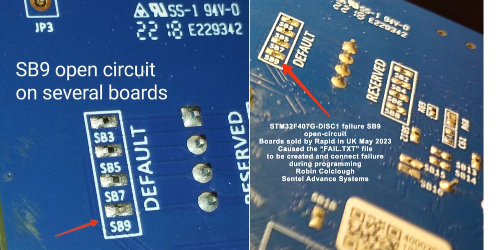

After using STMCubeProgrammer 2.21 to set the RDP byte to BB, the board works fine, but Cube programmer is later unable  to access the board; I've tried different modes, under reset etc.  The disk folder shows when plugged in to the USB with FAIL.txt listing and a connection error message.
This only started happening after updating the programmer a week ago.
Has anyone had this problem and found a solution? Thanks
Robmar
Senior III
Manufacturing fault found on a batch of STM32F407G-DISC1 boards, after debugging the hardware SB9, a debug mode link, is open circuit on all the boards suffering from the link failure ("FAIL.TXT").
I attach a photo.  Repairing link SB9 fixed the link-fail condition on all the faulty boards.STM32F407G-DISC1_SB9_fail_20230725.jpg

With BOOT0 HIGH you might be able to walk it out via the System Loader off the UART. Watch how PA9/PA10 are wired, and the capacitor.
Could try updating the ST-LINK to a Segger J-LINK OB firmware, as Segger has had tools previously to unlock/mass-erase STM32 parts.
Yes but this has never happened before, only since the last update.  The IDE seems to have been updated with a different link firmware than the Programmer, so swapping between the two both prompt to update the link firmware, its a bit of a mess.
Maybe its the link firmware used by the Programmer, someone must know.  I don't want to start having to do a batch of 200 boards with the UART

Thanks, these things happen, what's worrying me more is the state of the Cube IDE and software packs, which makes developing a functional product very difficult and more costly than necessary.
This is the batch number and one of the failed boards serial:-
4000293 1901 001532 2224
C223802587
