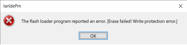

I have flashed the SBSFU application with by mistake write protection enabled for flash address 0x08000000. I am unable to erase using jlink commander.exe as well as by IAR->project->Download->erase. Please suggest me how to erase the flash of STM32H743II.
mr.1
0693W00000aJZ1VQAW.png@Domenico​ This is the error i am getting from the IAR IDE.
