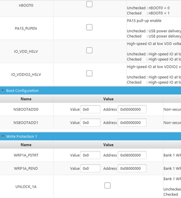

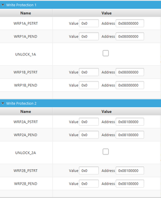

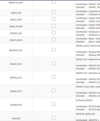

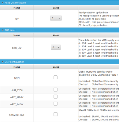

Now I'm no longer able to connect my board to STM32Cube Programmer, unless I keep on pressing the reset button. It seems like the regression.sh script erased everything, and there is no option byte configured, as by the pictures below:
I tried to set all of them manually, but the configuration is not saved, it cannot flash it onto the device.
When I release the reset button, the device disconnects:
  12:45:15 : Error: Unable to get core ID
  12:45:15 : Warning: Connection to device 0x482 is lost
  12:45:16 : Disconnected from device.
Your kind support please. Thanks!
