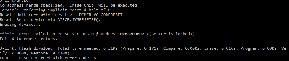

The other consequence is that I can't write a code anymode to this micro. I am using a J-Link and STMCubeIde and everytime I try it fails at the very beginning (compare 0%) then shows this error :
"ERROR: Timeout while calculating CRC, RAMCode did not respond in time."
At the beginning of the program the option bytes are modified to be able go in bootloader mode in some situations. That's why I was thinking that while writing the option bytes the STM32 got interrupted and it may have harmed the STM / the program.
I tried to start from fresh, erasing the flash using J-Link Commander v7.86.
But I was not possible because the flash is locked.

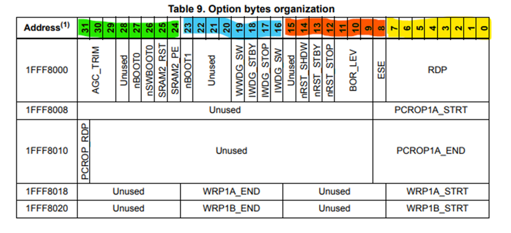

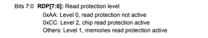

I can't read the flash where the program is but I can read the Option Bytes at address 1FFF8000: 3D FF F1 AA.
Meaning the read protection is not active.

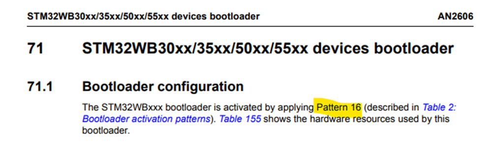

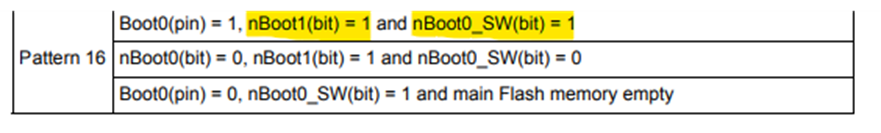

In the meantime I was able to see what was the state of the nBoot0 (1), nSWBoot0 (1) and nBoot1 (1). So with this configuration and by pulling the pin BOOT0 high I should be able to go in bootloader mode but it doesn't. The STM is not visible anymore when connected via USB as it was before the incident...

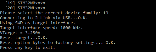

Use the "J-Link STM32 Unlock" tool.

Hi Piranha,
Thanks for your help.
I didn't mention it but I already tried that.
Because I think it's just changing the RDP bits to have a read protection to level 0.
2023-02-27 12:39 PM
https://wiki.segger.com/J-Link_STM32_Utility
"it unsecures a read-protected STM32 device by re-programming the option bytes to factory defaults"
Does reading the memory work after the unlock and erase, but before loading any firmware?

I tried again unlocking using the "J-Link STM32 Utility" and I can't read the flash memory either before or after a reset. I haven't been able to load any firmware since the incident so I can not deactivate it as far as I know.
> The option bytes, which are actually loaded by device, must be checked at option byte registers, not at the FLASH memory. Check the contents of FLASH_OPTR and the OPTVERR bit.
I can't read the content of those registers. I'm only able to read the option bytes.
2023-03-05 5:06 PM
FLASH_OPTR address is 0x58004000 + 0x20.
There are many protection options on your MCU, like PCROP and other. All of those should be checked.
