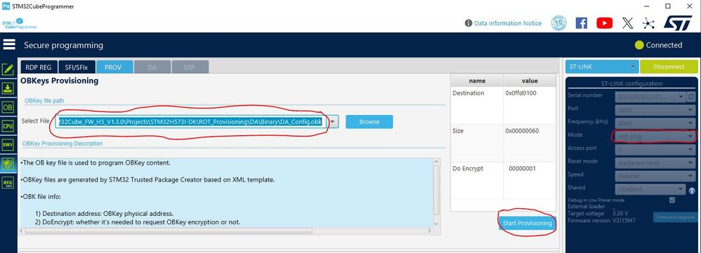

My STM32H573I-DK demo board is stuck in PROVISIONING state, probably as the result of a failed or aborted provisioning operation. I was doing hand-on training with the How to start with STiRoT on STM32H573 wiki.
Now, I cannot regress it to OPEN, or run the provisioning.sh script again to proceed to CLOSED. Any attempt ends up in a Debug Authentication Failed error.
I am aware of the importance of providing DA credentials to avoid locking the device in CLOSED state. But I don't think I missed this step, and my device is not CLOSED.
Any idea how I can unlock this board ?
Thanks for any support.
Christian R

2024-11-05 1:17 AM
Hello @CRE
As you are in provisioning state, you can still doing the provisioning manually.
Launch cube programmer GUI, connect in hotplug mode.
Then click on the shield, select the DA_config.obk ( from the Cube) and start provisioning.
Then you should have a pop-up that the povsioning was success full.
Once this done the regression script could be launch.
Or you can do the regression thank cube programmer GUI.
Br,
Frantz
2024-11-05 2:58 AM
Hi Frantz,
Thank you a lot for the quick and detailed answer.
I put your suggestion to trial:
- manual provisioning : appeared to be successful. Yet, the device was still in PROVISIONING state after that.
- regression : with the script or from STM32Programmer, both failed. The process went a bit further than before (signing token):
2024-11-05 4:35 AM - edited 2024-11-05 4:37 AM
Hi @CRE ,
please do the provisioning with the DA_Config.obk from the archive attached and then do the regression with the cert_root.b64 from the archive with cubeprogrammer.
I would suspect that you've regenerated the root key but haven't regenerated the associated certificate.
Br,
Frantz
2024-11-05 5:03 AM
Hi Frantz,
You fixed it ! My board is back to OPEN, and I will be able to resume my training.
And I will carefully follow every step of the wikis, and avoid messing around.
