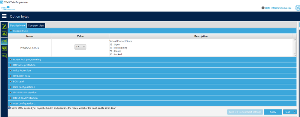

i've set the PRODUCT_STATE of my STM32H7S78-DK in the STM32CubeProgrammer from Open (39) to Revisioning (17):

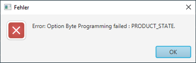

When trying to reset the state to Open again I get following error:
Is there a way to reset to the product state to Open again? I've read that there should be the possibility to do a full regression in PRODUCT_STATE Provisioning but how do I do that?

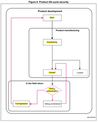

Hello @rk_iot;
I recommend you to follow the steps shared in 4_debug_authentication to reopen the device.
For more information about the different product state, you can look at RM0477 section 4.9 Product life cycle.
Thank you.
Kaouthar

rk_iot
Hello  @KDJEM.1 ,
thanks a lot we could reset the PRODUCT_STATE to Open again thanks to you instructions.
Best regards
