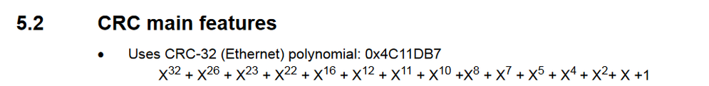

As far as I investigated, the first part of your statement is right: STM32F0 has a simple CRC with limited settings.
But about the second part, I make no mistake choosing my micro from the list.
I think the problem is due to STMCubeIDE lacking integrity and compatibility. Because even if I choose STM32f030k6 and enable its CRC in simplest mode, again the above errors appear!
‎2022-08-05 3:11 PM
I'm not using CubeMX/CubeIDE and this code generation / boilerplate stuff, so I'm not going to get into an argument about who's fault specifically this is, as honestly I don't care.
You're trying to compile a project where the code, the settings, or something is internally inconsistent, and divergent from reality.
Modify the code or project metadata so that it works with CPU you have. It's perhaps a define somewhere, in one of the files, or passed to the compiler's command line.
‎2022-08-11 6:53 AM
Final Answer:
Yes, As you said and based on f030 datasheet, it has a 32bit fixed polynomial. I hope in the next version of STM32CubeIDE, the issue will be resolved (Enabling CRC for f030 makes error).
