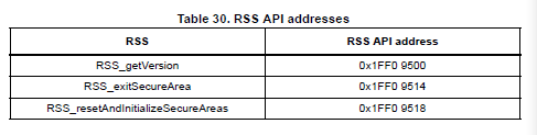

‎2023-10-19 2:17 AM
Hi, I believe this is what you seek
BR,
J

‎2023-10-23 12:59 AM
Hi!
Thanks. Yes this is what I was looking for. Example configuration and activation RSS.
I analyzed the source code. Correct me if I misunderstood the sequence of actions.
1) First, it is necessary to activate Security bit mode through Options Bytes - HAL_FLASHEx_OBProgram(...).
2) Then, use the RSS API to set the secure user memory area SFU_LL_RSS->resetAndInitializeSecureAreas(1, aSecureAreas);
Do you possibly know of a project with source code that is solely dedicated to the activation of RSS? With all possible argument checks, guard conditions, and error handlers.
I want to understand the entire state machine of the controller's behavior because incorrect arguments in the secure user memory will lead to a complete lock-up of the controller, even without activating RDP2.
Best regards,
Mikhail
