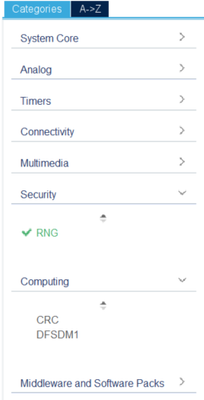

I am Missing the Option Security>RNG in my the .ioc tool. Does the F446RE does not have a RNG?

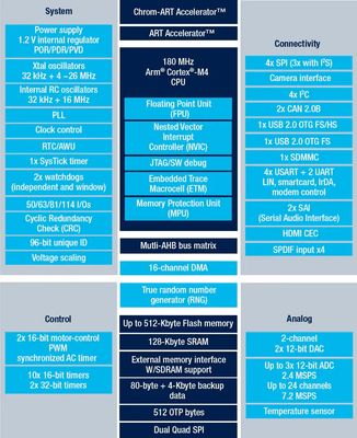

2023-12-04 5:55 AM
Well, this could be a copy'n'paste error, for which I would like to apologise. However, only the functions and parameters in the data sheet are relevant and guaranteed.
2023-12-04 2:53 AM
For my L452RE it looks like this:
2023-12-04 4:59 AM
Correct, in contrast to the STM32L452RE, the STM32F446 does not contain an RNG.

2023-12-04 5:37 AM
2023-12-04 5:55 AM
