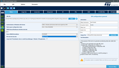

In the secure manager configuration, you have this NS reserved area that is made for this purpose. Here below an example where I setup 16KB (2 flash sectors).

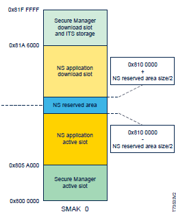

These sectors are actually located at end of flash bank1, beginning of flash bank 2.
You can find the details in UM3254 Rev5 chapter 7: Flash memory mapping:
So, are you using this NS reserved area ?

Hi Jocelyn,
Thanks for your quick answer. I definitely failed to configure this NS reserved area, and consequently, I was storing my data in the NS code area.
However, I do configure it now, as per your example, and I went through all the steps of the How to start with Secure Manager (customized configuration) on STM32H5 wiki. But I keep loosing my data after every firmware update.
