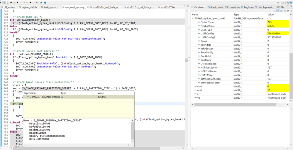

I'm run a STM32H573DK in OEMiROT example.
but following errors occured.
[INF] TAMPER Activated
[INF] BANK 1 secure flash [0, 15] : OB [0, 14]
[ERR] Unexpected value for secure flash protection
so, I find why occurred this error.

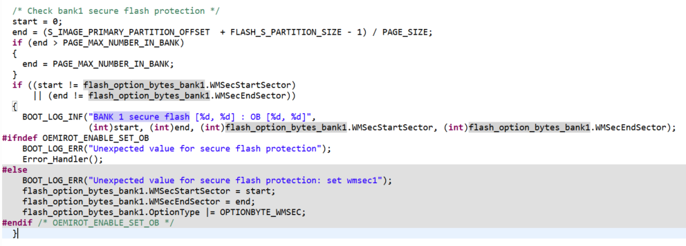

In the ob_flash_programming.bat file, sec1_end was set to 0x0E.
but In the code end value is set to 0x0F
end = (S_IMAGE_PRIMARY_PARTITION_OFFSET + FLASH_S_PARTITION_SIZE - 1) / PAGE_SIZE;
( end = 0x1E000 / 0x2000 = 0x0F )
what is correct?
what do i fix?
ps. I'm using STM32Cube_FW_H5_V1.1.1

Jocelyn RICARD
January 2, 2024
Hello @Choppa ,
I have just checked the OEMiROT projects (Boot + secure/non secure application) and I don't get this issue.
On my side
S_IMAGE_PRIMARY_PARTITION_OFFSET = 0x18000
FLASH_S_PARTITION_SIZE = 0x6000
This makes 18000 + 6000 - 1 = 0x1DFFF
Divided by sector size 0x2000, I get 0xE
Did you change anything on the default configuration ?
For your information, you can debug this setup in full open state.
Select OPEN finale state during the provisioning script. Set BOOT0 switch SW1 as requested and you can then attach debugger to check what exactly fails.
Best regards
Jocelyn
ChoppaAuthor
January 8, 2024
hello, Jocelyn
No, I didn't change configurations.
but I find diffrent points.
S_IMAGE_PRIMARY_PARTITION_OFFSET = 0x1a000
==>  FLASH_AREA_BEGIN_OFFSET = 0x18000
        FLASH_AREA_4_SIZE = 0x2000
and FLASH_S_PARTITION_SIZE = 0x6000.
is this issue causing from configuration?

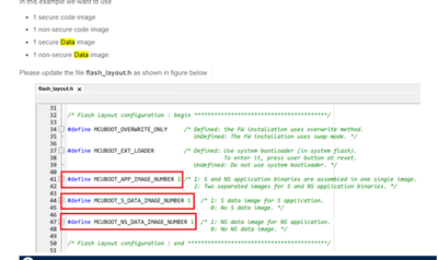

Jocelyn RICARD
January 8, 2024
Hello @Choppa,
if FLASH_AREA_4_SIZE = 0x2000, this means you have changed the configuration in flash_layout.h adding the secure data image setting MCUBOOT_S_DATA_IMAGE_NUMBER to 1 instead of 0.
Could you please, clean all your projects, rebuild everything, and then launch the provisioning.bat file provided in the ROT_Provisioning\OEMiROT.
I think it should solve your issue.
Best regards
Jocelyn
ChoppaAuthor
January 9, 2024
you mean. should I MCUBOOT_S_DATA_IMAGE_NUMBER  set to 0?
but according to example  MCUBOOT_S_DATA_IMAGE_NUMBER is set to 1
and I set the MCUBOOT_S_DATA_IMAGE_NUMBER to 0.

Jocelyn RICARD
February 23, 2024
Hello @Choppa ,
thanks to a customer having same issue as yours I could figure out the source of your issue.
In fact, the information I was missing is that you changed the configuration.
I guess you set MCUBOOT_S_DATA_IMAGE_NUMBER = 1 or something equivalent.
Setting this changes the flash mapping.
To make your life easy, the new flash mapping is automatically computed and the scripts setting the options bytes configuration are updated.
The point is that, when using STM32CubeIDE, only .sh scripts are updated, not bat scripts that are used in case of IAR or Keil.
So, if you launch provisioning.sh instead of provisioning.bat it will work.
Launching the .sh scripts from windows requires that you have a bash available in your path
Best regards
