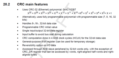

Hello @FrankYang-P&S
The "No-Stretch GetCheckSum" command in I2C bootloader is explained in section "2.20 No-Stretch GetCheckSum command" of AN4221 "I2C protocol used in the STM32 bootloader".
This command is used to compute the CRC value (based on the CRC hardware IP) of a given flash memory range, defined by the memory offset and size.
The CRC algorithm implemented in the CRC hardware IP (see CRC chapter 20 of the Reference Manual) is CRC-32 (Ethernet) polynomial: 0x4C11DB7
Note that this command is supported in the I2C bootloader protocol version 1.2 and later ( see table 3 of AN4221). I can list for example the STM32H5 series and the STM32U59/5A that support this command.
You can share with me the STM32 family you are using and I will tell you check if this command is supported or not.

hello @akn
Thanks, yes it is the algorithm used by all the STM32 Families, however it is a hardware accelerated algorithm.
I confirm, we can emulate the CRC behavior using your shared code.
For more information about the CRC peripheral can be found in AN4187 (Using the CRC peripheral on STM32 microcontrollers - Application note
