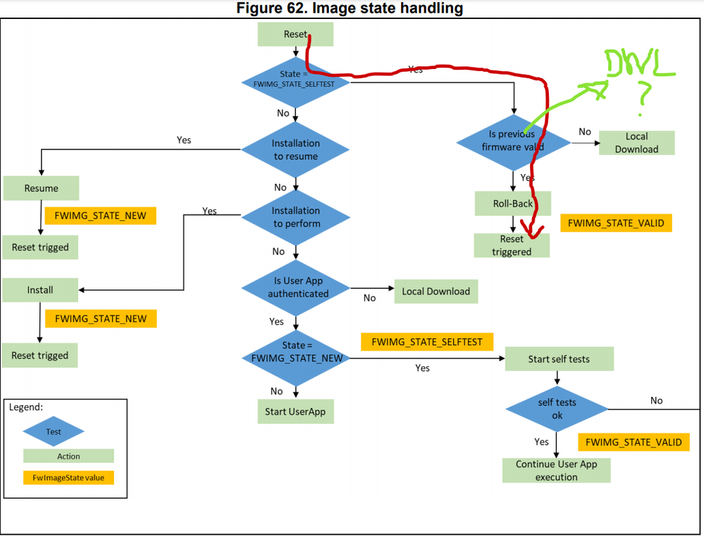

Hi @JHOUD​, thanks for your answer and for the reference to Appendix J. I did not know it existed.
I've attached the flow image, combined with poor drawing skills. So looking at my output log and the flow, I guess my scenario follows the red line. A couple of follow-up questions:
  • So it checks "Is previous firmware valid?". I guess the "previous firmware" is the one in the DWL slot.
    • Is it somewhere during this test that in my scenario the "backed-up FW is not identified" message is generated? (Or is it in the next "roll-back step"?)
    • However, no local download is started (as indicated in the flow when the test fails). Is this because there is already a firmware in the DWL slot? I think this part in my output logs is rather weird: it says the rollback failed (because of error), so I guess it won't rollback to the image in the DWL slot, but on the next reset it does install that firmware from the DWL slot.
  • You mention: "generally it means the header contents do not match". You mean the header contents of the image in the ACTIVE and DWL slots? Why do those header contents have to match for a rollback? Can't these be different images, so shouldn't the header contents differ? Probably I do not entirely comprehend the meaning of the header contents.
Thanks in advance,
ac_gd

Hi @ac_gd​ ,
yes, the red line shows the flow that I believe describes best your case.
The flow is high-level, it's easy to see that not all code branches are included, only those needed to understand the underlying principle. So in reality I'd say the error message is generated in between.
I think I know what's exactly happening, but I don't have time to test it today. Please hold.
For the header-slot relationship, I'm going to steer your attention to Appendix B describing the dual slot configuration. The header contains both "measurements" (length, integrity) and the life cycle information.
Rgds,
Jarda
