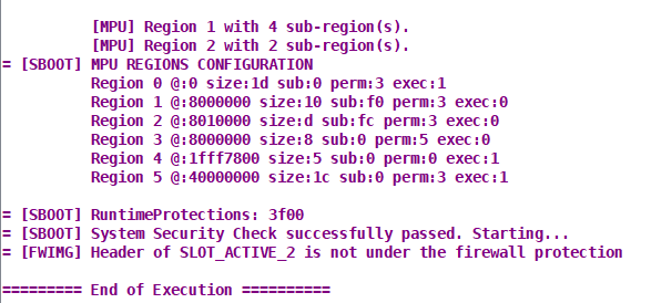

I am trying STM32CubeExpansion_SBSFU_V2.4.0 with 2 Active images and 2 Download areas and assigned the LOcation in mapping_fwimg.icf. Code is building but i am getting error = "[FWIMG] Header of SLOT_ACTIVE_2 is not under the firewall protection"
‎2021-05-09 1:35 AM
Please guide me how to add SLOT_ACTIVE_2 to firewall protection.

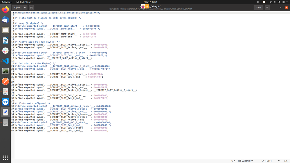

There is only one project on L476RG in​ STM32CubeExpansion_SBSFU. It is working with out any issue. But I added 2 active and 2 download slots by modifying Macros SFU_NB_MAX_ACTIVE_IMAGE and SFU_NB_MAX_DWL_AREA. And even i added memory locations in mapping_fwimg.icf. Please refer the image attached. I am getting error SLOT_ACTIVE_2 is not under firewall protection.

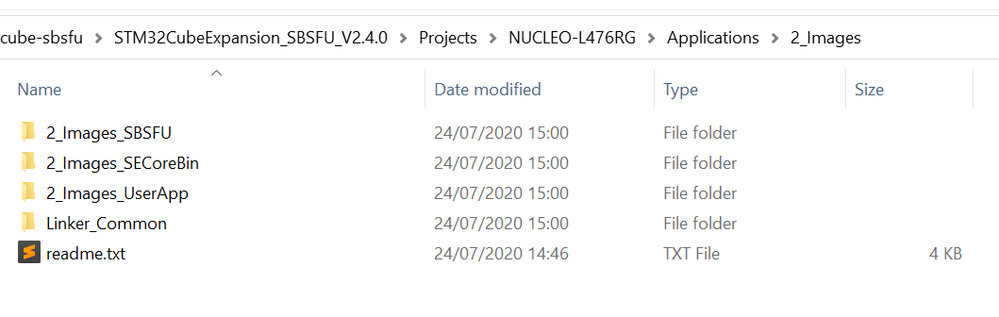

For me, I found 3 different projects which are :
- 2_Images_SBSFU
- 2_Images_SECoreBin
- 2_Images_UserApp
Best Regards,
Ons.
‎2021-05-17 6:39 AM
All 3 projects we need to add, That is interdependent. Please check Readme for compilation order. And follow https://www.st.com/resource/en/application_note/dm00414677-integration-guide-for-the-xcubesbsfu-stm32cube-expansion-package-stmicroelectronics.pdf
