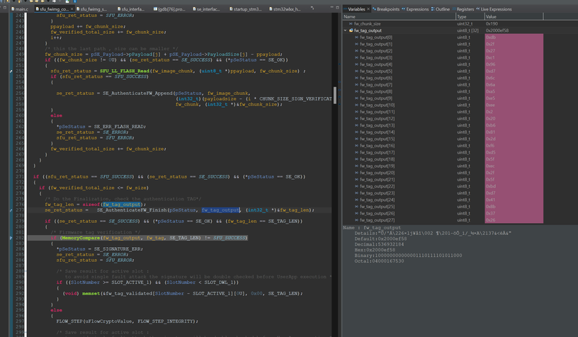

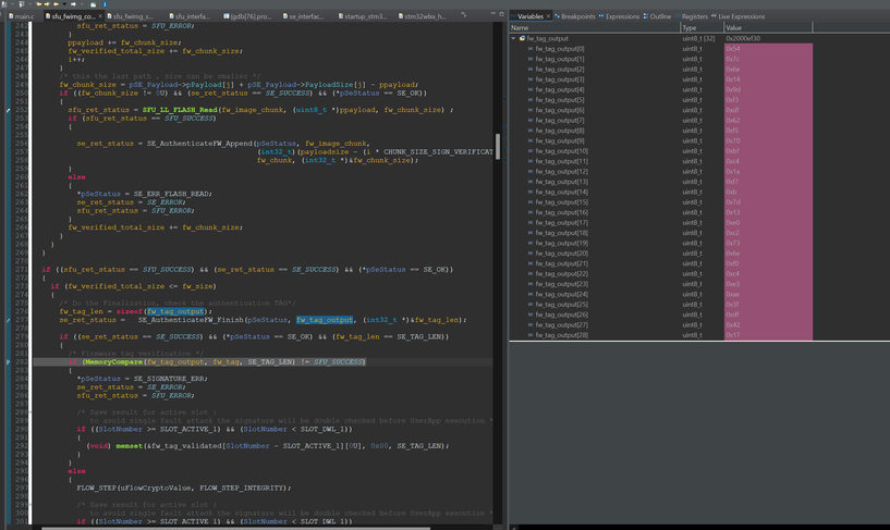

However, I'm facing an issue when attempting to update from the EEPROM. I encounter a "Fw signature check error" during this process. Upon debugging the BFU (Bootloader Firmware Update) application, I noticed that the C_DigestFinal function returns the wrong pOutputBuffer specifically when updating with a .sfb file. Interestingly, the same function returns the correct tag when we flash both the bootloaded and firmware as one image but still can't make upadate with .sfb file.

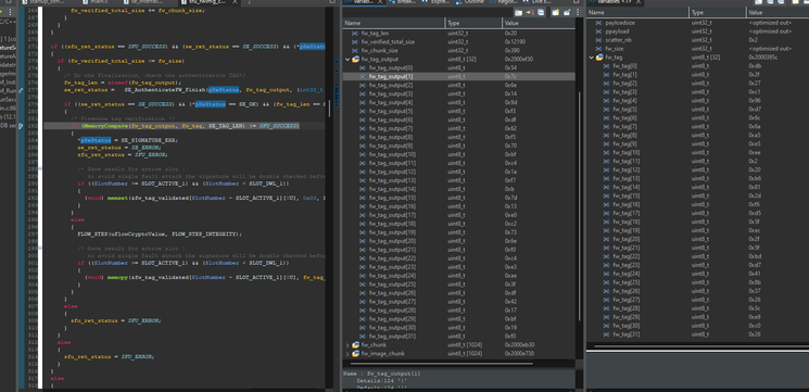

Below we see that the fw_tag_output is correct and the installed image pass the check

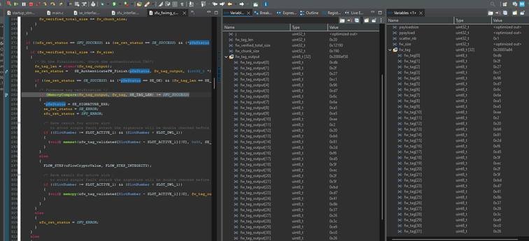

Now we see that the same application when i send the .sfb file over y-modem for update the kms returns the wrong number.

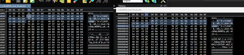

The authentication tag on both firmwares (full firmware .bin & Generated .sfb) is the same on the beginning section 0x200.
The C_DigestFinal when is called shouldn't be always check with the same tag? What i mean is that the Authentication tag key with size 32 bytes on the first section of the flash is always the same?
Below is the image from both header binary files. The tag values are the same.
Do i messing something about how the C_DigestFinal works?
The result using the full image BFU + Firmware:
The same during update from the y-modem:
Best regards,
Nikos
