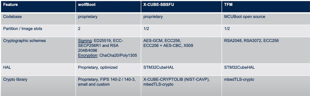

@Jocelyn RICARD​  is X-CUBE-SBSFU(STM32H7) support RSA (2048/4096) cryptographic scheme to sign Firmware ..??
For me it looks like only ECC256 is supported.
0693W00000LwlwqQAB.pngI didn't find this information from UM2262.
Can you confirm on that please ..??
Hello @SPati.7​ ,
yes I confirm that X-CUBE-SBSFU does not provide any support for RSA for firmware signature.
Best regards
Jocelyn
