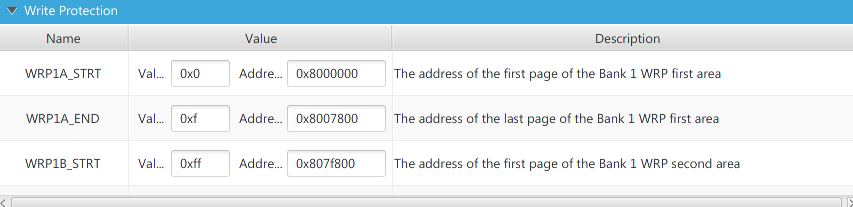

Hi support team,
i am testing the sbsfu code in P-NUCLEO-WB55 but i missed out to disable security ips SECBOOT_DISABLE_SECURITY_IPS and flash into the board it set RDP level to 1 also set SFU_WRP_PROTECT_ENABLE, SFU_TAMPER_PROTECT_ENABLE,SFU_DAP_PROTECT_ENABLE,SFU_MPU_PROTECT_ENABLE... .
now i want to remove this code and flash other application but i can not debug or run as application via IDE(AC6 or cubeide) it through error: write protection detected check RDP and WRP protection options.
Please help me out to resolve above issue.
I have change RDP from 1(BB) to 0(AA) but issue is not resolve.
Thanks,
Arjun

Per RM0433 and UM2262 and others...
An RDP L0 regression from L1 performs a mass-erase.
So you have to connect a ST-LINK or similar, change the RDP to level 0 (which does the mass-erase) and disable the WRPs.
This leaves user flash empty.
Then you have to re-load the combined SBSFU and app, or just the SBSFU and use it to re-load the app.

Thanks for quick response i am using stcubeprogrammer for change RDP level, it change successfully from 1 to 0 but i can't find how to disable WRPs
please find attached image
Thanks,
Arjun
‎2020-04-17 3:25 AM
Hi @alister​
Thanks for your support resolve the issue by changing WRP1A_START and WRP1A_END (WRPxy_START > WRPxy_END = No WRP or unprotected, as mentioned in RM0434 ).
Thanks,
Arjun
‎2020-04-17 4:09 AM
STM32CubeProgrammer isn't intuitive. You'll have to check RM0434 and try to correlate its description of WRP with this GUI.
Alternatively, if you have an older tool called "STM32 ST-LINK Utility", that was pretty easy to understand.
