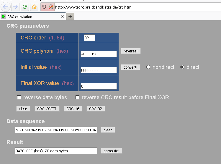

waclawek.jan
October 21, 2021
How exactly did you generate the example data in your first post?
Try a simpler/shorter packet. Try to show us in http://www.zorc.breitbandkatze.de/crc.html the settings producing the expected values.

waclawek.jan
October 22, 2021
The CRC unit in STM32 is configurable, its configurability depending on the particular model.
However, as Clive (TeslaDeLorean) said, if you write data by words, they are treated as big endian, which is not a configurable item. I took the data from your initial post, omitted the last byte (so that I had only 28 bytes = 7 words), swapped endianity and fed it to http://www.zorc.breitbandkatze.de/crc.html to get the above result:
Luckily, in 'L4, you can write data into CRC_DR byte by byte, doing that you can bypass the problem of endianity. It appears that CubeL4 supports this by setting hcrc->InputDataFormat = CRC_INPUTDATA_FORMAT_BYTES
