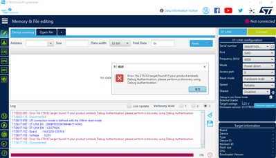

as mentions on title,
my target board is NUCLEO-C031C6. and I change the read protection level of flash from 0 to 1(0xAA to 0xBB) by STM32CubeProgrammer.
after that, the target board can not be connect any more.(keil c/ cubeMX/ cubeProgrammer/ ST-Link Utility...)
the error message is as below:
I have read related issues on forums and tried some methods from forum, ...like change [reset mode], [mode], or hold reset button and release followed by click [connect]...!
however that doesn't seem to be helpful for my situation.
any other advice will be very appreciate,
thanks~

Hello @bvd ,
I'm asking this detail, because if you put RDP level 1 and boot_lock in the same time, the debug capability will be disabled and the device locked.
Can you try to connect the product through the Cube Programmer power down option ?:
Best regards,
Simon
hello Simon:
I have try (hot plug/ normal/ under reset/ power down) mode, it still not work,...the target can not be detected and show message as below:
the only different is when I click [Connect] on power down mode, the error message appears 1 sec slower than other modes.
thanks so much ~

Simon.T
To lose debug capability when the RDP level 1 is set in association of BOOT_LOCK is the normal behavior.
This behavior is described in the FLASH security register (FLASH_SECR) page 78 via a caution note:
After setting RDP level 1 and boot lock, re-enabling of debug capabilities is possible only by setting the DBG_SWEN bit by the application code.
Best regards,
Simon
Hello @FArdi.1 ,
BOOT_LOCK=0x1 and RDP=0xBB, as stated in the reference manual
https://www.st.com/resource/en/reference_manual/rm0490-stm32c0x1-advanced-armbased-32bit-mcus-stmicroelectronics.pdf
3.7.13 FLASH security register (FLASH_SECR)
Caution: If the bit is set in association with RDP level 1, the debug capabilities are disabled,
except in the case of a bad OBL (mismatch).
So you will not able to connect, except if  you re-enable  the debug link in your code.
For example on button press :
void HAL_GPIO_EXTI_Rising_Callback(uint16_t GPIO_Pin) {
//This will reopen the debug
SET_BIT(FLASH->ACR, FLASH_ACR_DBG_SWEN);
Then you can connect in hotplug mode and do a regression
stm32_programmer_cli -c port=SWD freq=8000 mode=hotplug -ob RDP=0xAA BOOT_LOCK=0
Take care any trial to connect a part in RDP1 will lock the flash and will request a power cycle to have the embedded software running again.
