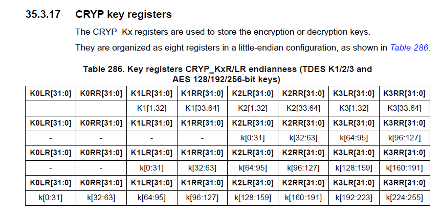

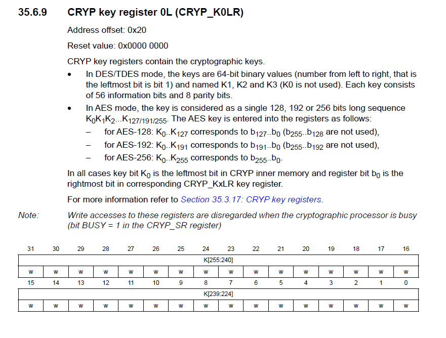

Following this question, I am also confused about how to fill the key in the CRYP peripheral. I don't find the Ref Manual very clear
The register description mentions the key as an array K and an array b where MSB of K are in lowest address register.
But it seems to be different in the key registers section of the doc.
Basically an AES key would be an array of bytes, and I can't figure out how I fill these bytes in the key registers...

Hello @Gpeti​ ,
I would guess this is same issue as for IV.
The STM32H7 Cube provides an mbedTLS wrapping to the CRYP peripheral in
STM32Cube_FW_H7_V1.10.0\Projects\STM32H743I-EVAL\Applications\mbedTLS\Crypto_Selftest
You can see in aes_alt.c how the mbedTLS input key is transformed into Cryp compatible key using:
  /* Format and fill AES key */
  for( i=0; i < (keybits/32); i++)
    GET_UINT32_BE( ctx->aes_key[i], key,4*i );
Where GET_UINT32_BE is implemented as:
#define GET_UINT32_BE(n,b,i)              \
  (n) = ( (uint32_t) (b)[(i)  ] << 24 )       \
    | ( (uint32_t) (b)[(i) + 1] << 16 )       \
    | ( (uint32_t) (b)[(i) + 2] << 8 )       \
    | ( (uint32_t) (b)[(i) + 3]    );      \
This should help you finding the good implementation

Hello, I had a closer look to the GitHub example code, and it's still confusing. the example you copied tends to indicate that the Key and IV registers are big-endian (GET_UINT32_B converts an array of 4 bytes into a big-endian represented 32 bits value). However the ref manual says:
The swapping operation concerns only the CRYP_DOUT and CRYP_DIN registers. The
CRYP_KxL/KxR and CRYP_IVxL/IVxR registers are not sensitive to the swap mode
selected.They have a fixed little-endian configuration
