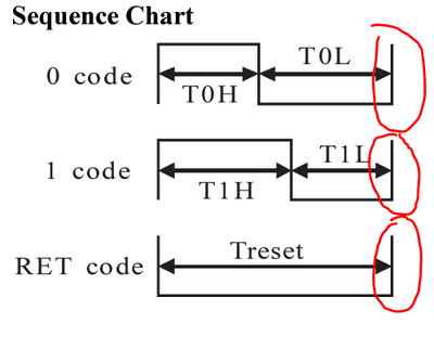

My code does what I want it to do, verified by oscilloscope, i.e. it's not my code that is the problem. That's why I did not want to post this as the first thing. I think the behavior of the WS2812B is more interesting :)
It works 99% of the time, so my main focus is to get some ideas of what can cause this instability.
From your former post, I saw that you mention the data line to be LOW after the LOW reset period, between the updates.
Mine is left HIGH. The data sheet does not really tell me exactly, but this indicates that HIGH should be OK:
I had 50 periodes of LOW after each update, to make a 50*1,25 = 62,5us RESET periode (>50us).
I have now tried to let the signal stay LOW also after the RESET periode, and until next update. I did not succeed, it just keeps go HIGH after the DMA finnishes. Also if I do not call the STOP DMA function.

For WS2812 data line in HIGH state is the same as sending 1. You are doing strange things. Just keep the data line at constant 0 (low) between transfers. All of this looks like a simple problem with your code - incorrect encoding or wrong reset timing. The only requirement for T0L and T1L is that it must be shorter than Treset (so it may be, for example, 5 us - no problem). Only T0Hmax and T1Lmin timing is really critical; T1H may also be much longer than the officially specified value. In other words, TxL of the last data bit *IS* Treset - the data line should not go high after the last data bit sent. There are many versions of WS2812 and WS2812-alikes which differ mainly by the minimum Treset (there is no maximum value); 60us may be too little for some versions. The correct sequence is: at least 60 periods of 0 state (constant 0, not data bits of value 0), data bits, then stay in 0 state as long as you want (so simply go back to the beginning).
Also, some WS2812-alikes require longer T1L, so it might be a good idea to set the PWM period to 4 cycles instead of 3 (which is the normal value for the original WS2812). WS2812 will be perfectly happy with it, since, as I wrote above, TxL max is not critical..

> Of some reason, the port pin is more high impedant in this case, despite the fact that all registers/config of the  GPIO/Timer/DMA is exactly the same.
By "port pin" you mean the pin controlling the LED?
No it isn't; from insufficient data you've drawn incorrect conclusions .
It's probably the surrounding circuitry (probably the QSPI pins and tracks) which are of different impedance, thus changing the amount of coupling between the NFC circuitry and the LED-controlling pin+track. This should be relatively simple to test.
I also reiterate the fact that GND is always part of the circuit.
