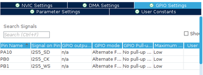

H730 is really fast switching, so try: set port/pin speed to low , if not perfect then,  then try with a series resistor cpu/pin -> 100 ohms -> WS..../data line ; and check good solder contact to GND plane -> WS.../gnd line .
Fast response, thanks :)
When I use DMA, I have limited possibilities to set the port pin config: Both speed and drive strength is not available in CubeMX when the pin is not a generic GPIO port pin.
I will check and test with the limiting resistor.
Hey, DMA or not - you still use the pins and this you can set !
ie. here dma -> spi -> GPIO pins

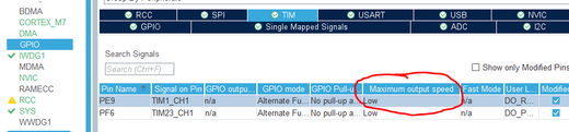

Yes, you are right. When used with the DMA/PWM, the port pin disappears from the normal GPIO list.
But I can see it's in the TIM section (of course).
The speed is set to low already:
