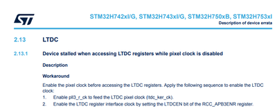

Tried to write a basic ltdc test not using hal and wen I pause the debug wen  changing a ltdc register it disconnects and says could not be halted whats going on

There is a known limitation when accessing to the LTDC registers.
Please check if you have the same conditions as described in the STM32H753 Errata sheet

I'm not at my computer now but really it's wen any change happens to any ltdc register
