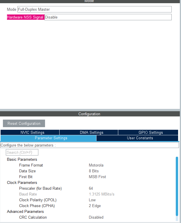

STSM32 SPI configuration:

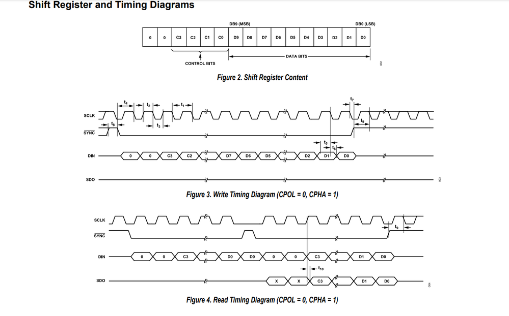

As you can see form above CPOL = 0 and CPHA = 1 (2 edge) this is required for AD5270.

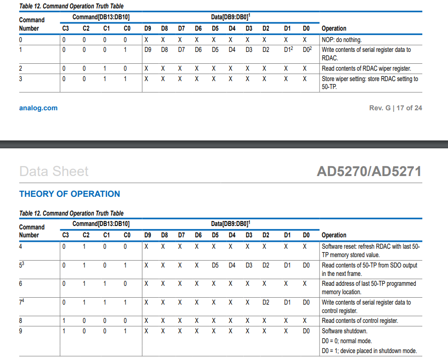

According to AD5270 documentation:

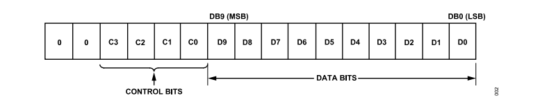

As you can see from the first image, I am mainly interested in Command number 1 (Write contents of serial register data to RDAC)
C3 C2 C1 C0
0 0 0 1
I am now trying to build a correct frame for writing 10 bit value to set the potentiometer value
I am a little confused regarding MSB/LSB. Could someone clarify How do I build correct frame and which order do I need to send bytes. At the moment, I have written this function:
//WRITE_RDAC = (1<<2),
void AD5270_WRITE_RDAC(uint16_t value){
// first 2 bytes are 0, then 0 0 0 1 D9 D8,
// so the frame look like (when value = 16)
// 0 0 0 0 0 1 0 0 0 0 0 1 0 0 0 0
// so the frame look like (when value = 2)
// 0 0 0 0 0 1 0 0 0 0 0 0 0 0 1 0
	if(value > 1024){
 DEBUG_PRINT("Input value out of bounds \n");
 return;
	uint8_t spi_data[2] = {WRITE_RDAC,value};
	AD5270_CS_Enable();
	HAL_SPI_Transmit(&hspi1,spi_data, 2, 0xff);
	AD5270_CS_Disable();

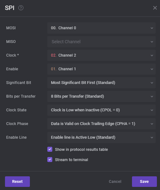

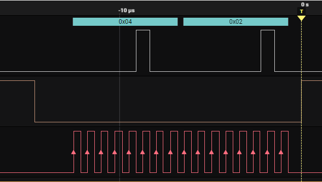

Logic analyzer settings:

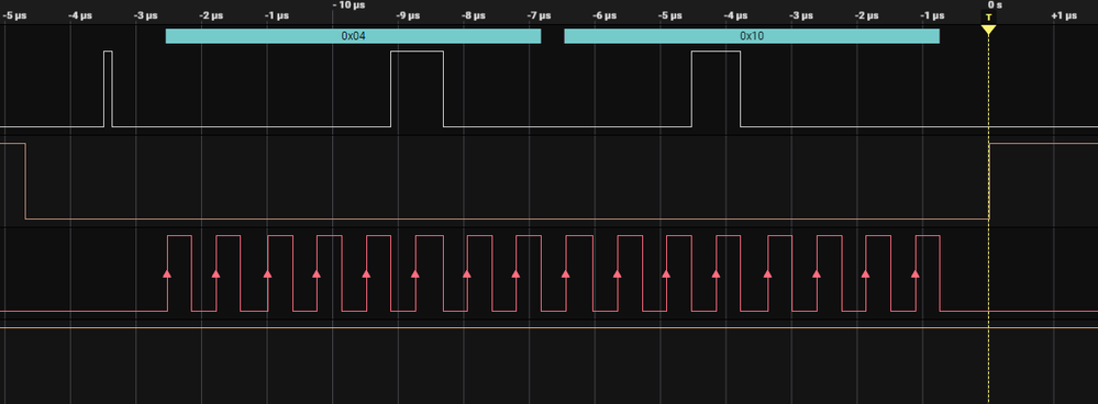

I tried to execute the following command:
AD5270_WRITE_RDAC(16);
 And I see on the logic analyzer:
When I try to send:
AD5270_WRITE_RDAC(2);
The signal looks like:
I just want to understand whether my frame is incorrect or I should be looking at hardware issues (maybe the chip is faulty or something else). I am monitoring Wiper (W pin on the AD5270) using digital multimeter and it does not change when I send the commands. I expect the resistance to change when I write different values to RDAC. The resistance is always set to 900Ohms and its not changing.

waclawek.jan

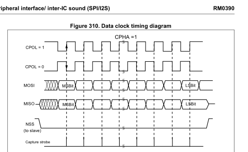

CPOL=0 and CPHA=1 means "shift on rising edge, sample on falling".
On the waveforms you've presented it's the other way round.
Read out and check your SPI registers' setting.
