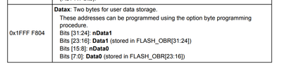

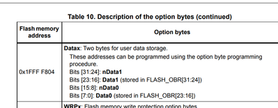

This is what the reference manual is saying. It's accessible over this address: 0x1FFF F804
But it can contain only two bytes and their opposite (Datax and nDatax) and you need 4-bytes storage!
In the CubeProgrammer I've written 0x12 in Data0, 0x78 in Data1:
Read in software:
key = *(uint32_t*)0x1FFFF804;
key contains 0x8778ED12
ED the bitwise inversion of 12 and 87 is the bitwite inserion of 78.
Read in software:

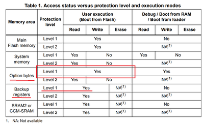

Since, you mentioned BitInversion,  will it automatically inverted while storing this two byte in Option memory ?
If we enable RDP1 , will this two byte as well be read/Write protected ?
 Yes. It's automatically inverted. The inverted values are not accessible by the user. I think it is used mainly to check the consistency.
@bsuthar wrote:
@mƎALLEm , This is useful.
Thank you,
Emm that's a good question. I'm not expert of security subjects. You can ask it in the STM32 Security forum but according to the AN4758 "Proprietary code read-out protection on
STM32L4, STM32L4+, STM32G4 and STM32WB Series"
Both Option bytes and Back-up registers are accessible at RDP1. So I think you need to use the internal Flash. No way ..

Are you pointing out because of limittaion of 4 byte storage ?. we can shrink Key to 2 byte to be stored in Option Byte.
No, I'm saying that option bytes are not protected by RDP1. Please read my previous post. Meanwhile you can confirm by asking that question in STM32 Security forum as I'm not a security expert guy.
