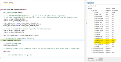

I tried changing the sequence up slightly... as you can see, via JTAG, we can verify the two option bits do get set to 0, however, HAL_FLASH_OB_Launch seems to reset them both to 1.  And this explains why we go to user code and not DFU.  What do I need to do to get these options to persist for the restart into DFU?
Second question:  Once I update firmware via the ST programmer, do I need to toggle the option bits back to 1:1 for normal user mode or does the  DFU tool do this for you automatically?

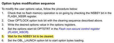

You need to launch option bytes while they are still unlocked.
Here's a random example that shows how to use HAL_FLASH_OB_Launch correctly:
STM32CubeL5/Projects/STM32L562E-DK/Examples/FLASH/FLASH_WriteProtection/Src/main.c at 0ae29ef5d6cab23f1d0c15aa948bf0b36285c6d9 · STMicroelectronics/STM32CubeL5
You're also missing step 5 in the procedure.
Consider using HAL_FLASHEx_OBProgram which does this for you.

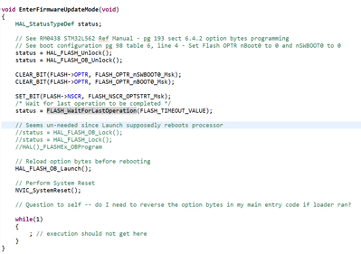

I looked through the sample you pointed to and reviewed your sequence above.  I modified the code as follows and now the status returned from Wait for last op is 128 -- FLASH_NSSR_NSPGSERR  -- programming sequence error.
What am I missing?  Flash and option bytes are unlocked, clearing the 2 boot bits shows 0s.  Opstart followed by wait for bsy to clear returns error 128.  Isn't this the sequence needed?

Grizz
The final solution was close to what we discussed in this thread... seems there needs to be a wait before and after the OPSTART.  Seems writing those boot bits causes a flash update which takes a few clocks to complete.  The final code is as follows (and yes, I had to reset those option bytes using the STM32CubeProgrammer after a firmware update).
Thank you for your help.
