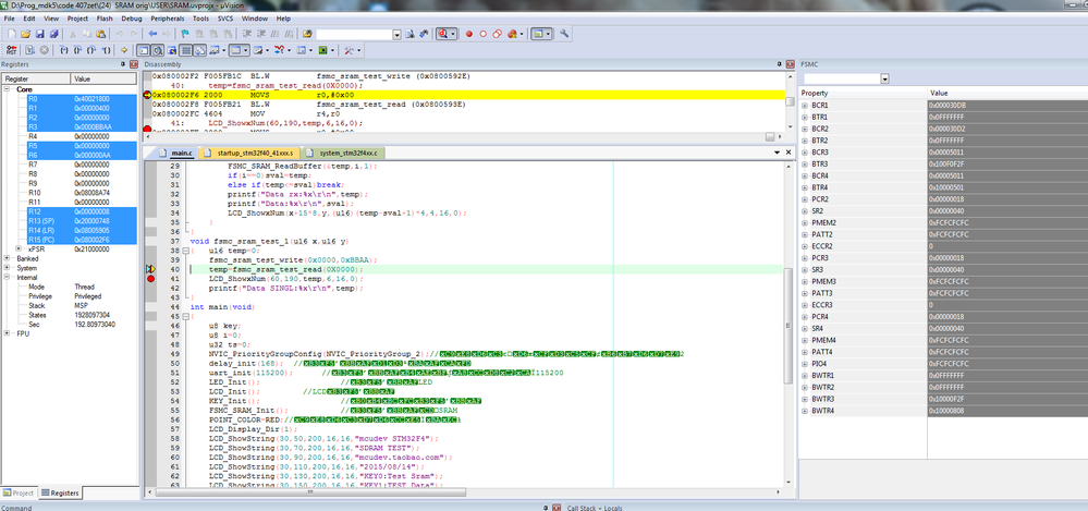

waclawek.jan
Read out and check/post content of FSMC registers.

По�?ле запи�?и в пам�?ть

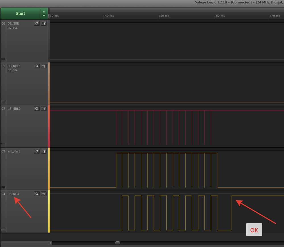

when one of the devices is turned off, the behavior of the CS (NE3 or NE4) signals becomes normal. disconnected separately the memory on the NE 4 logical analyzer; SWITCHED NORMALLY; turned off the screen (by setting comments on the screen); NE 3 switching is normal (attachment). The combined operation of the screen and memory causes a single change in the signal from 1 -> 0 at the outputs of NE 3 and NE 4

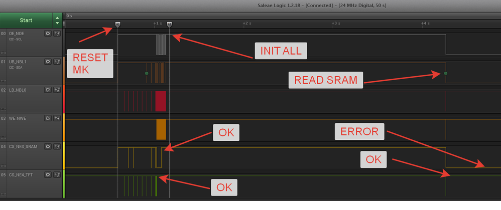

Changed the initialization order, at the beginning of the screen then the memory. The screen selection signal NE 4 now works fine. BUT the memory selection signal does not work. In the attachment, the screen from the moment the microcontroller resets.0690X00000BwltDQAR.png
Maybe something is wrong with the memory access? I give all the pieces of the appeal code:
