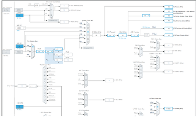

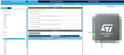

Can you implement the following code in your project?
If everything is implemented correctly, the STM32 enters stop 2 mode after one second and wakes up from it after another second. The PA5 pin will be set to verify the operation. You can use the USERLED for visual verification.
Cube MX configuration:

gilberto-falker
Hi
It solved the problem.
BR
Gilberto
