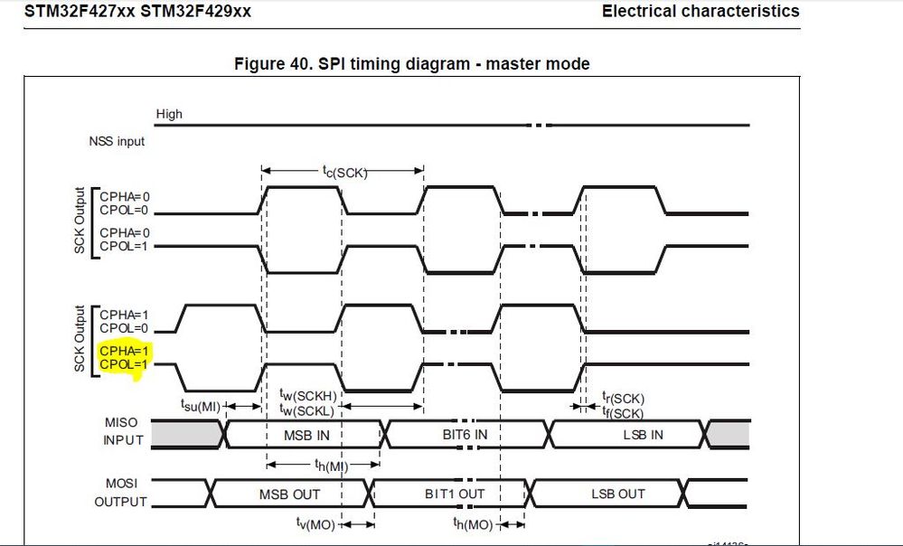

2021-03-12 01:23 PM
Hello
for CPHA=1 and CPOL=1 the captured image does not have any bit shift. The output result is 0100 0101 (bit swapped) that is 0x45
Revise the use of pullups or pulldowns resistors (if exist) to fit with clock polarity and the other signals
check SPI registers if have the values that initialization code set.
