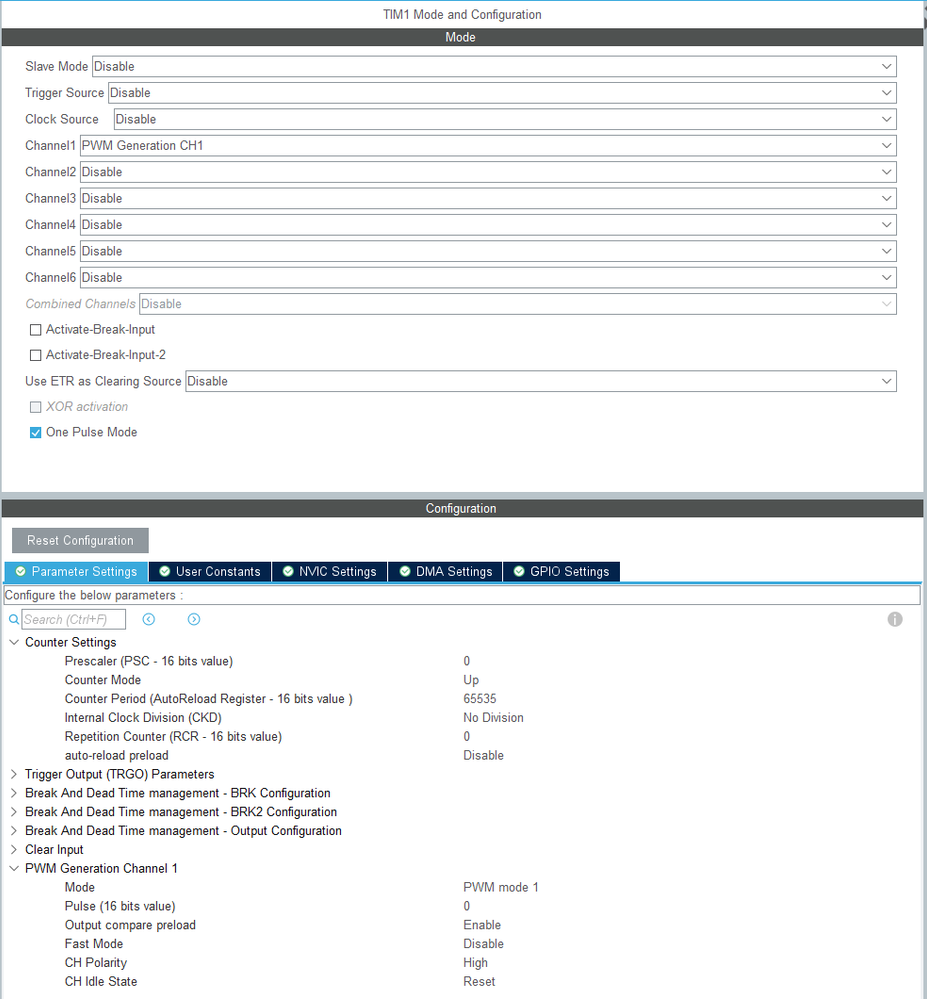

I need to generate PWM signals with adjustable number and frequency to drive a step motor. I expect the frequency ranges from 50Hz to 200KHz and the pulses count ranges from 1 to 2k.
I have tried 3 different ways including: using timer interrupt to count the pulse number; setting the PWM timer as master and using a slave timer in gated mode to count the pulse; using One Pulse Mode and the 16bit Repetition Counter (RCR). I used to think the last is the simplest and the most reliable cause all of the work is done by hardware. But the problem is the same. When the frequency reaches 200kHz the pulses count is inaccurate. More precisely, the count is always less than expected.

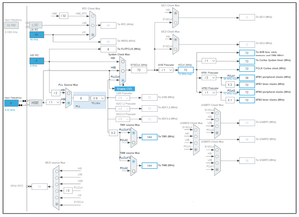

0693W00000WIC15QAH.pngshould be:
emm...I don't know why. But yes, the timer goes well without selecting a clock source in CubeMX. Maybe the default is Internal Clock. And I have just tested to set the Internal Clock. But the problem remains even when the frequency is just 20kHz.
Here is my clock configuration.

There are many things wrong. As already noted, several timer registers are preloaded. The timer clock is not 144 MHz - even the CubeMX shows it clearly and correctly.

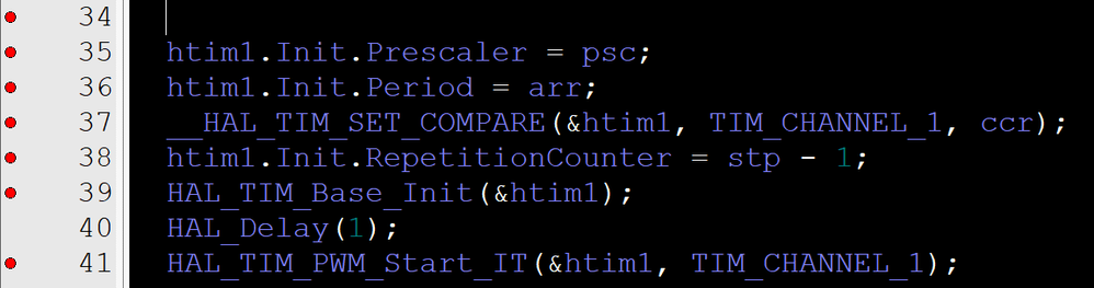

Thank you! I just checked the content of every register of TIM1 in debug mode. I found the cotent was accurate in debug mode. And the pulse count was also accurate up to 200kHz. The difference between debug mode and normal startup, I think, is the delay between breakpoints. So I just add a 1ms delay and the problem disappears.
0693W00000WIDOPQA5.pngMaybe it needs some time to reload the register...
Thank you for your great advice!
