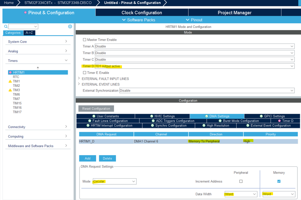

Hi all,
I wanted to make a post to shine some light on how to configure the HRTIM DMA on the STM32F3348-DISCO (and probably other ICs w/ HRTIM capabilities).
A few posts I've seen have boasted the same solution, but have convoluted the use of a single DMA request, Burst DMA requests and general Burst Mode configuration using the HRTIM. Here I'll try and walk through a step-by-step CubeMX and main.c configuration to step through a sine table with a circular DMA request to create a high frequency PWM sine wave using HRTIM1. Some basic knowledge of the ST Cube suite is assumed.
  1. Start a new CubeMX project - Select "Start My Project from ST Board" --> Search "STM32F3348-DISCO" --> Select board and "Start Project" (initialize peripherals in default mode).
  2. In Timers -> HRTIM1: disable Timer C (this example we'll only use Timer D)
  3. In Timers -> HRTIM1 -> DMA Settings: Add HRTIM1_D and set:
    • Direction = Memory to Peripheral
    • Priority = High
    • Mode = Circular
    • Data Width = Word
  4. In Timers -> HRTIM1 -> Timer D: Only change the following settings, leave the rest unchanged. Some settings will be set in Cube IDE.
    • Timing Unit -> Preload Enable = Preload Enabled
    • Timing Unit -> Number of Timer D Internal DMA Request.. = 1
    • Timing Unit -> Number of Timer D Internal DMA Request.. -> 1st DMA Request Source = Timer repetition DMA request enable
    • Timing Unit -> DMA Src Address = (uint32_t)&signal[0]
    • Timing Unit -> DMA Dst Address = (uint32_t)&(hhrtim1).Instance->sTimerxRegs[(HRTIM_TIMERINDEX_TIMER_D)].CMP1xR
    • Compare Unit 1 -> Compare Unit 1 Configuration = Enable
    • Output 1 Configuration -> Set Source Selection = 1
    • Output 1 Configuration -> Set Source Selection -> 1st Set Source = Timer period event forces the output..
    • Output 1 Configuration -> Reset Source Selection = 1
    • Output 1 Configuration -> Reset Source Selection -> 1st Set Source = Timer compare 1 event forces the output..
  5. Generate your code into STM32CubeIDE (need to change default toolchain in Project Manager tab).
  6. Copy and paste the contents of the attached main.c file. The important things are:
    1. Sine lookup table is pre-generated and stored in uint32_t array "signal" of size "NS".
    2. HAL_HRTIM_WaveformOutputStart is called first inside main function, then HAL_HRTIM_WaveformCountStart_DMA.
    3. Inside MX_HRTIM1_Init(): pTimeBaseCfg.Period = PERIODpTimerCfg.DMASize = NS;
  7. Debug as STM32 C/C++ Application (assuming board is connected properly).
Hooking an oscilloscope up to PB14 (on STM32F3348-DISCO) you should see a PWM wave with a frequency of 100kHz changing duty cycle rapidly.
Hopefully this helps clarify some of the ambiguity of configuring the HRTIM. I'm excited to go further and sync some basic sampling with a few of the ADCs on the chip.
