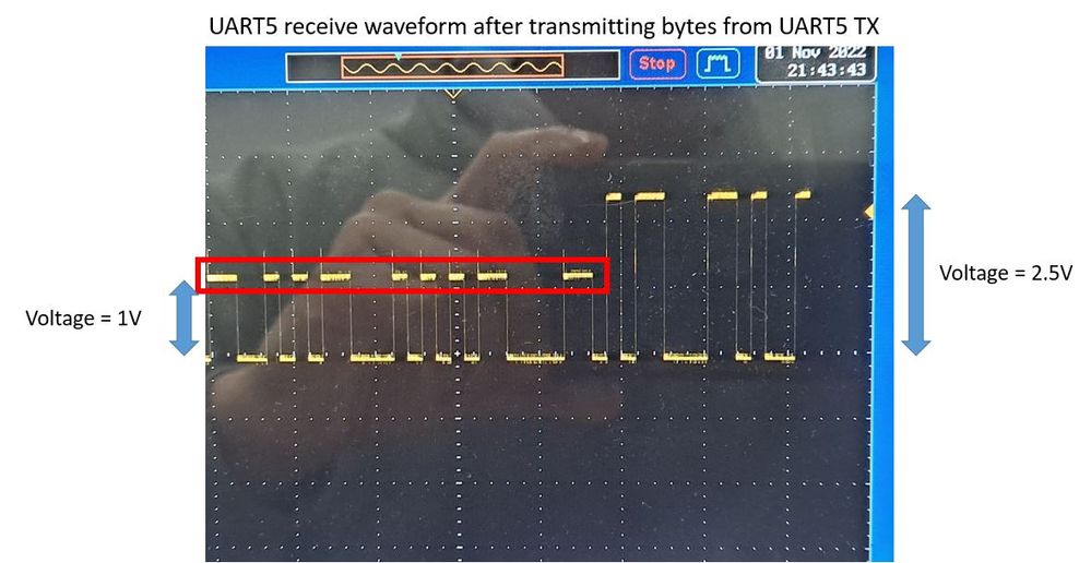

I am using STM32F405 UART5 to receive data using interrupt.I generated base code using STM CubeMX.
The problem is when I don't transmit data from UART5 TX, the UART5 receiver works fine. But if I send data from UART5 TX, the first 2-3 bytes voltage drops to ~1V so the microcontroller does not recognize it and I am unable to receive the first 3 bytes.
When I do not use interrupt and use polling method, there is no problem.
I am sending and receiving data from PC through FTDI4232 USB-TTL converter to STM32F405 board.
The code is shown below. This is a Main Application part whose address starts from 0x8008000.
I have a separate bootloader program from which the program jumps to Main Application program. Does the jumping from Bootloader part to Application part impact the UART5 receiver.

The UART5 receive data waveform after I transmit from UART5 TX is below : 0693W00000VOmRlQAL.jpgTTL connection setting.

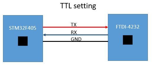

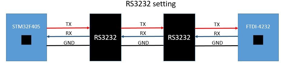

0693W00000VOsLtQAL.jpgI connected them to FTDI directly through TTL interface and through RS232 interface. But I get same behaviour in both of them.
The TX/RX cross connection is verified because I have transmitted and received bytes simply. And the ground connection in all of the boards are also common.

Looks to be ​a hardware side issue.
How exactly do you have this​ wired up? What board?
Common Grounds?
Cross connected or shorted to a secondary pin?​
FLast.5
My connections are shown above. Hope they answer your questions. The TX and RX are crossed accordingly and the systems have common ground.
Even I thought it to be hardware issue, but after checking with USB-TTL converter directly and connecting through RS232 converter in between as shown in figure above, I have suspicion in interrupt receiver.
