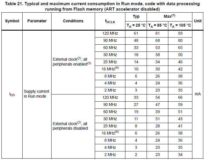

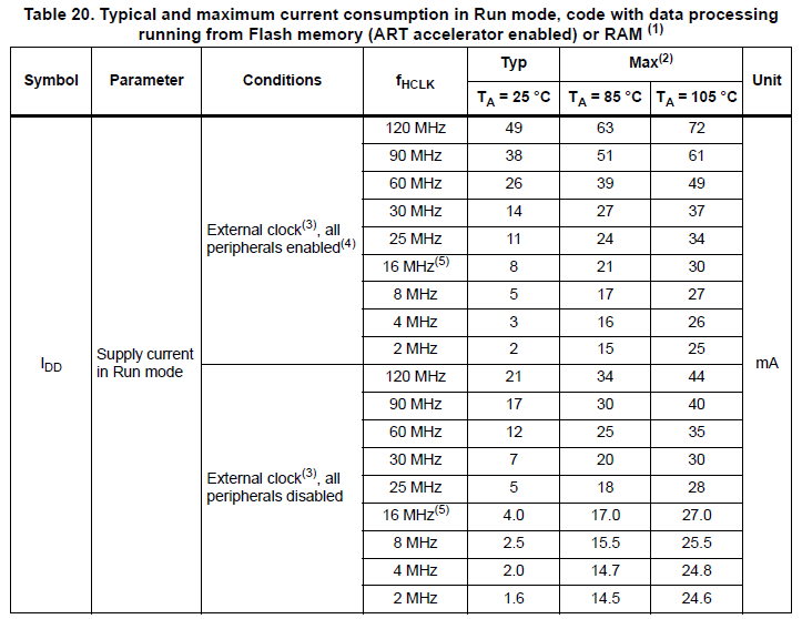

First I read it in a book Mastering STM32. When you ask me for the reference manual I said "It's true, I shuld have used a references manual", so I checked the STM32F205xx user manual.
Tables 20 and 21 in page 78 and 78, respectively, show the current in RUN MODE. Table 20 with ART accelerator enable, and table 21 with ART accelerator disable.
When ART accelerator enable the current consuption is 38 mA, and when it is disable the consuption is 48 mA.

‎2020-04-13 12:10 PM
Note that the first table's description is "... or RAM", with footnote 1, which says, \
1. Code and data processing running from SRAM1 using boot pins
I'd like to hear ST's explanation (including the interpretation of these figures in AN3430 where this footnote is conveniently omitted).
Also:
All Run mode current consumption measurements given in this section are performed using CoreMark ® code.
CoreMark is a synthetic benchmark which does not very well represent real-world code; contrary - the jumpcache (which is mostly what ART is) favours the tight loops of which the bulk of CoreMark consists. This allows ST also to claim the "0WS" performance, which is a marketing lie.
This is also probably the cause of the weird recommendation of AN3430 to switch off the prefetch - prefetch (and particularities of its implementation are again not told by ST) is a feature favouring linear code, as opposed to the jumpcache.
Impact of both prefetch and jumpcache on the occurrence of actual read from FLASH has undoubtedly relatively dramatic impact on overall power consumption, given 20mA raw FLASH consumption as leaked by AN3430; and it's hinted also by prefetch being recommended to be switched off for decreased ADC noise in AN4073 (again with undocumented code and unanalyzed impact of that particular code).
So, in particular cases, it may quite well be that decreased FLASH read occurrence counterbalances the increased power consumption of the ART unit when switched on. However, while in real-world code there are often tight loops, but typically in controlling code there are often long heavily branching sequences and high percentage of interrupts (i.e. non-recurring code path change), rendering validity of synthetic benchmark questionable.
