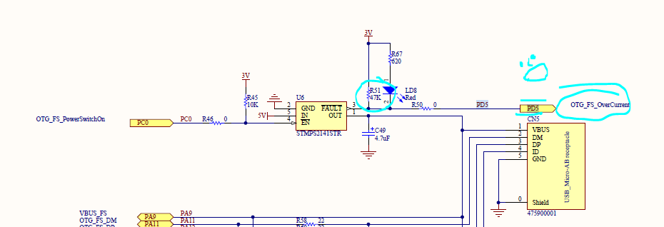

Here is the code:
RCC->AHB1ENR|=RCC_AHB1ENR_GPIODEN;
GPIOD->MODER&=0UL;
GPIOD->IDR&=0UL;
There are 3 volts on pin 5 of port D (I checked with a multimeter).
The IDR register looks like this: IDR: 0000 0000 0010 0000
The ODR register looks like this: ODR: 0000 0000 0000 0000

You didnt specify , but if you are using a STM32F4DISCOVERY board (making a guess here).
The Pin D5 is tied to the USB otg current sense, this could be the reason youre unable to see 0v. (remove the R50 bridge to release that D5 from the usb otg IC )
https://www.st.com/resource/en/schematic_pack/mb997-f407vgt6-c01_schematic.pdf
