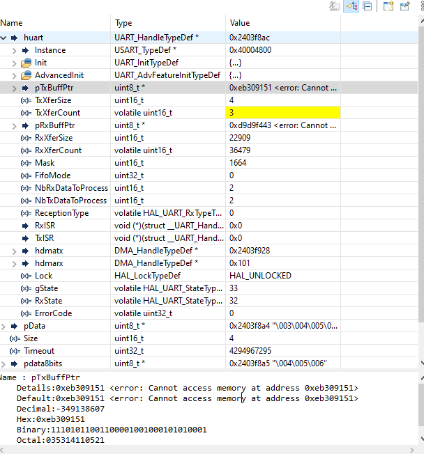

Using the debugger everything is going fine, except there is nohing to be seen on the Putty terminal anymore. I think I found the issue because it can't access the memory of the buffer;
Anyone knows how to fix this issue?
Edit: probably caused by the INIT function not working as expected

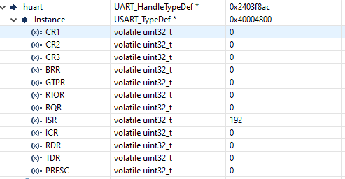

/*-------------------------- USART CR1 Configuration -----------------------*/
  /* Clear M, PCE, PS, TE, RE and OVER8 bits and configure
  *  the UART Word Length, Parity, Mode and oversampling:
  *  set the M bits according to huart->Init.WordLength value
  *  set PCE and PS bits according to huart->Init.Parity value
  *  set TE and RE bits according to huart->Init.Mode value
  *  set OVER8 bit according to huart->Init.OverSampling value */
  tmpreg = (uint32_t)huart->Init.WordLength | huart->Init.Parity | huart->Init.Mode | huart->Init.OverSampling ;
  MODIFY_REG(huart->Instance->CR1, USART_CR1_FIELDS, tmpreg);
While debugging I can see the CR1 is set to 12 for a fraction of a second. Only to be set to 0 again when it goes to the next line. Anyone knows why?

Check that structure is cleared properly.
Looks like you have invalid data, or it subsequently gets corrupted.​
Check startup.s clearing statics and running constructors properly.​
I don't know how to check this. The file looks pretty advanced.
0693W000008wVGIQA2.pngThis does also look pretty strange

I found the problem.
Seems it's better to call GPIO init AFTER the UART init haha. /facepalm
