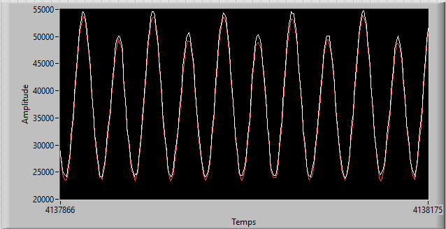

Why do my ADCs channels read the same signal within a sequence of regular conversion while the pins are not linked? (STM32H747)

Here is the code I use to read within a sequence the data from ADC1 chan 0 and ADC1 chan 16 with chan 0 being read before chan 16. However the data received from the ADC is just a copy of the data from chan 0. Here is a picture of what I read (red trace is chan 0 and white trace is chan 16), what is disturbing here is that there is no signal input on the pin linked to the channel 16! (I use DMA to manage the data could it be a part of my problem?)
