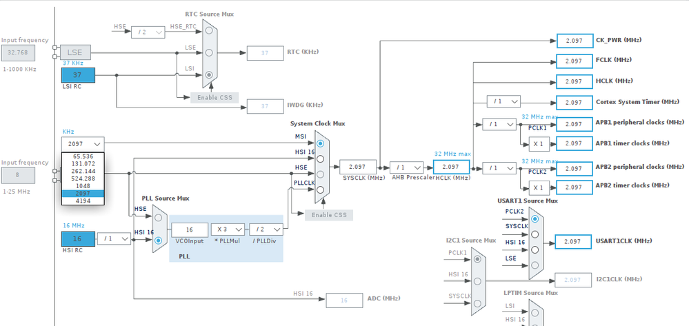

‎2022-10-03 11:57 PM
I'm not shure if my boss will give me the time to read whole books.
The IOC-editor is availlable in my toolchain (STM32CubeIDE 1.9). But I need to find out, which screw to turn on. I can set MSI RC to maximal 4194 kHz, which is twice as much as now, but far away from 24 or 32 Mhz as @Community member​ wrote.

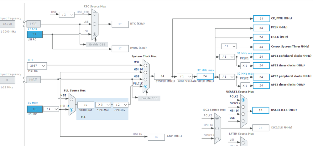

‎2022-10-04 12:25 AM
Can I switch to HSI RC and PLLCLK (without destroying anything)?So I would reach 24MHz.
Is this all I have to do?
‎2022-10-04 12:30 AM
right ! (as i showed in my post before ...)
‎2022-10-04 1:13 AM
Ok, thats easy.
(What are the advantages /disadvantages of MSI and HSI RC?)
I'll fetch the fire extinguisher and than give it a try.
Thank you.
‎2022-10-04 4:32 AM
The IRQ-variant works now on 24Mhz. I'm very happy and gratefull for your hints.and help.
Lets see, if I will get also DMA to work...
Thank you all.
