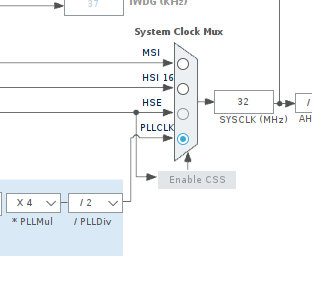

fast check: SYSCLKFreq_VALUE=2097000 ; so core running at 2 MHz ....what you expect from 2 MHz cpu ?
select PLLCLK clock as master:
Watch for blocking code in interrupts or callbacks.
DMA check error/status.
UART will stop if it has Noise, Framing, Overrun​ errors.
L0 should run 24 or 32 MHz
2.097 MHz is MSI clock it initially starts with.​

OK, thank you for advices. I'm shure, there is no blocking code in InterruptRoutines in my minimal testapp, only increasing testcounters, and in interrupt-version reactivating the interrupt
But I'm completely inexperienced what to do for getting a faster systemclock. Maybe I'll find a hint in the MCU manual. Or what would you suggest to make it running faster?​
(apropos of nothing: sending an answer to this forum with both of my smartphones browsers didn't work, I got an error "wrong Identifier yyyyyy" after pushing the [answer] button)
Johi
Senior III
Manipulating the clock frequency can be done in the clock configuration panel of the STM32CubeIDE IOC editor if you change the settings of the internal PLL’s, then the processor will run at other speeds. The availability of this tool depends on how your project was set-up. The alternative is to change the code in SystemClock_config() function or similar. Anyway if you are really serious about STM32 reading a few good books can provide the necessary background (e.g. Donald Norris, Programming with STM32, getting started with the Nucleo Board and C++)
