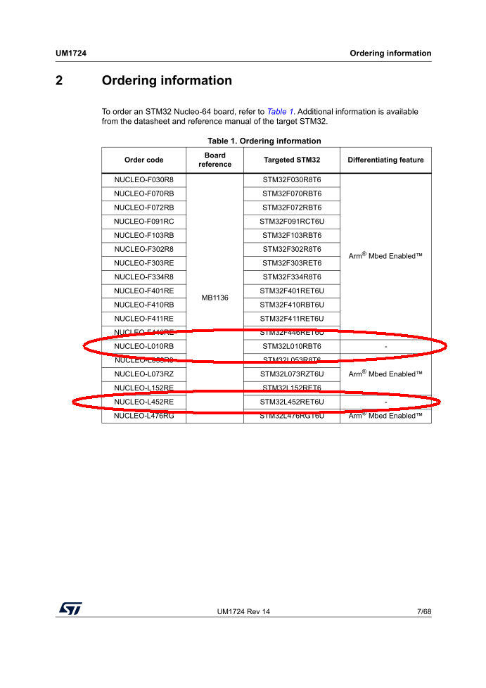

Which Nucleo-64 don't have STLink V2-1?
‎2023-03-23 11:49 AM
Perhaps the most unsettling thing on this is, that the two lists are entirely disjunct...

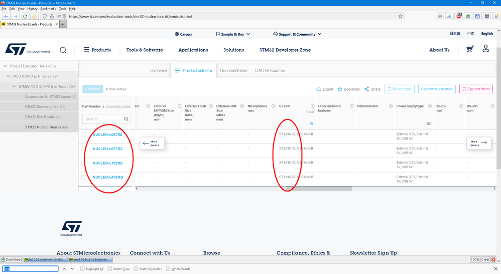

Your printscreens are difficult to read, please provide a link to the pages.

‎2023-03-24 1:23 AM
https://www.st.com/en/evaluation-tools/stm32-nucleo-boards/products.html - in ST-Link column, select ST-Link v2 (i.e. without the dash-one).

‎2023-03-24 3:50 AM
Hello Jan,
As far as I know, nowadays, the MB1136 boards are built with ST-LINKV2-1,
so for the 1st picture, yes, this is confusing, because L053, L076, L152 an L476 are capable of "Virtual COM Port + Mass Storage".
Maybe I'll try to find who can fix that.
And for the 2nd picture, the difference between "Arm Mbed Enabled" boards vs the others is whether they have a dedicated page here : https://os.mbed.com/platforms/
‎2023-03-24 4:09 AM
In this page the NUCLEO_L152RE is stated as STLINK/V2.
I have one: it has STLINK/V2-1. And it's written on the packaging!
This shows that the information on the ST site is not reliable.
‎2023-03-24 8:18 AM
Hi @Mike_ST​ ,
Probably I just remembered it wrong and all Nuclei had the vee too dash one ever since.
Thanks for the explanation of the mbed-enabled-ness. UM may have said so, e.g. in a footnote to given table.
The web needs more attention. There are Nucleo boards in the list with no STLink at all - is that the case? There was also a recent thread where @Pavel A.​ pointer out, that while every Nucleo has a dedicated webpage, the text there is just copypasted boilerplate which does not reflect the real features.
