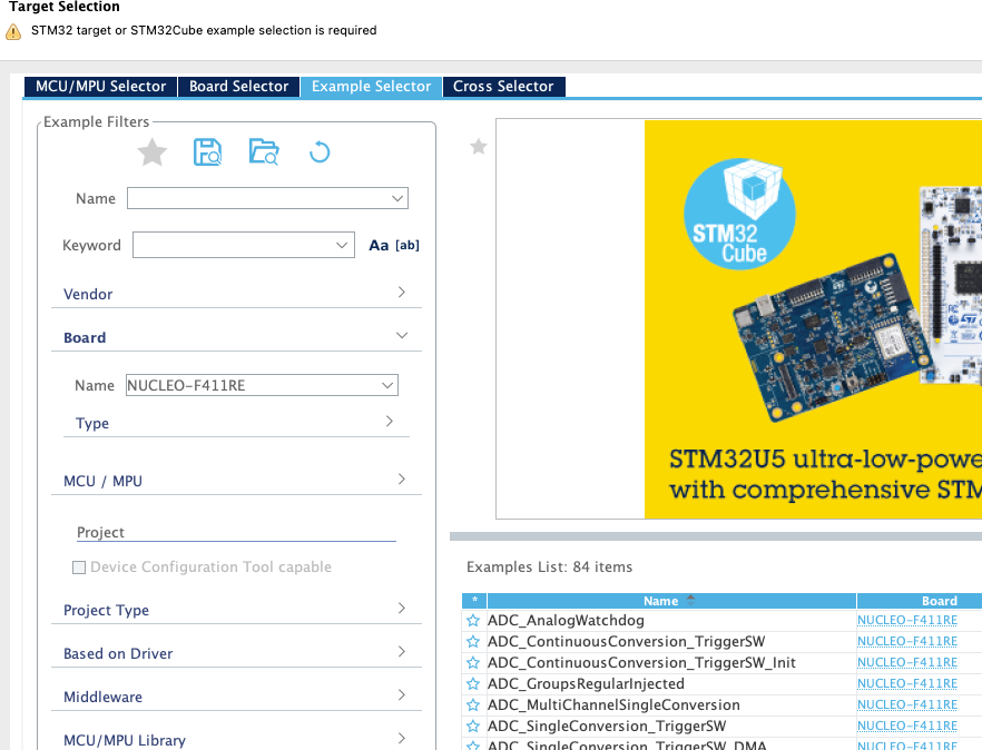

WHERE IS NUCLEO-F411RE demonstration and example source download?
BSpee.1
The "helpful" link in the getting started guide says it is available on www.st.com . Could someone be more specific? Thanks
BerndAnton
the easiest way to get the example code is via CubeIDE (https://www.st.com/en/development-tools/stm32cubeide.html )
  • create a new project.
  • go to Example Selector tab.
  • search your board
=> on the bottom right you get a list with all examples.

Muhammed Güler
Senior III
https://www.st.com/en/embedded-software/stm32cubef4.html
sample software is available in the firmware package. After downloading the file or after you find it already downloaded on your computer, you can check the directory below.
\STM32Cube_FW_F4_V1.27.0\Projects\STM32F411RE-Nucleo
Andrew Neil
https://www.st.com/en/evaluation-tools/nucleo-f411re.html#tools-software
