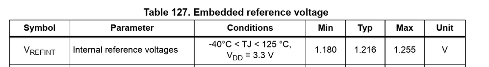

Hmm... to me Vref is the internal bandgap voltage around 1.23V, which ADC measured value at precise Vdd and Temperature is stored as calibrated data in Flash. The Datasheet will let you know where it is memory mapped. From Vref and Vtemp, the STM32 can deduct its Vdda voltage (Vdda=Vdd in most chips, it is the supply voltage).

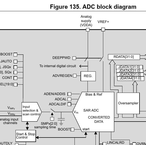

there are two "Vref" : the + reference of the sar adc and the internal reference source:
0693W00000aHfjtQAC.pngthis is what tried to explain.
int.ref.
0693W00000aHfkIQAS.pngand vref+ and vref- are on pins (or internal conn. to vdd/vss):
0693W00000aHfkXQAS.png0693W00000aHfkEQAS.png>cannot find where CubeIDE defines which reference voltage the ADC should have
because Cube cannot set, what voltage you supply to the pin (which is vref+)
ok now?

@AScha.3​ . Thanx. I suspected this. You wrote "because Cube cannot set, what voltage you supply to the pin (which is vref+)"
I thought some register needed to be set that tells the AD that "your ref is at pin VDDA, not the internal vref".
