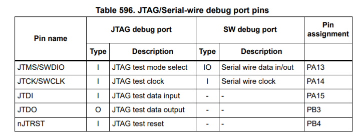

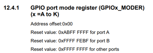

Look to the reset values of GPIO registers in the reference manual (RM0399) to get the exact answer. Here an example:
Pins used for debug purpose are the ones where there is an exception:
-Amel
