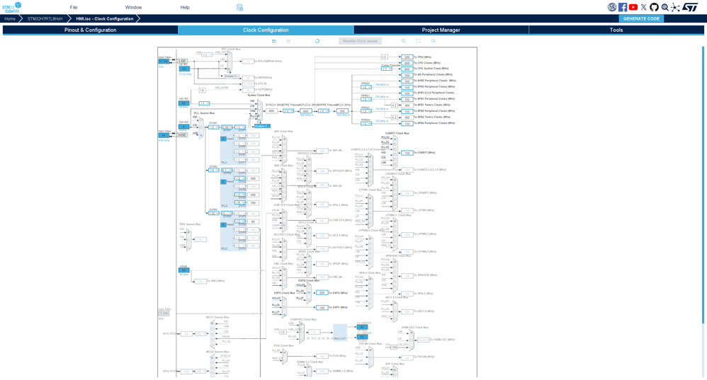

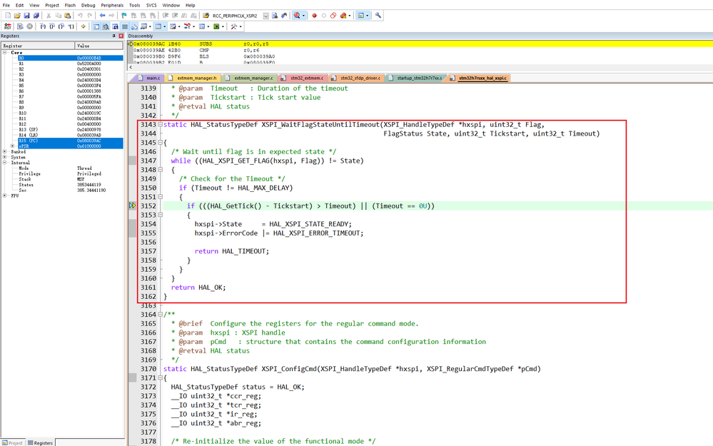

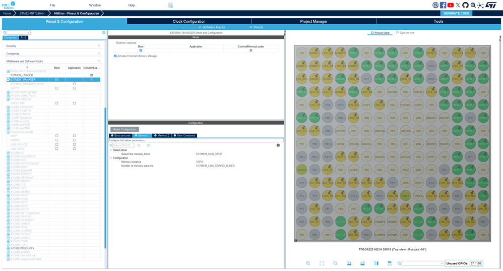

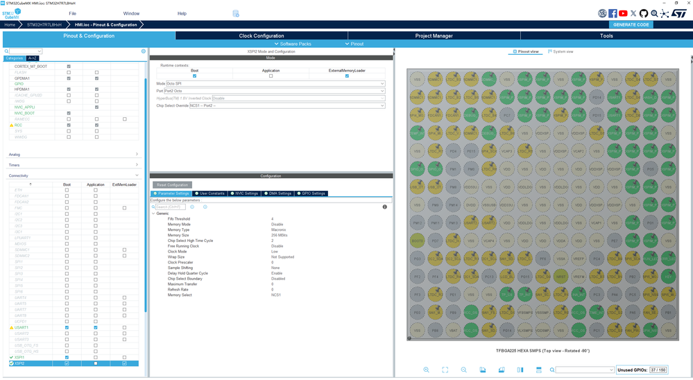

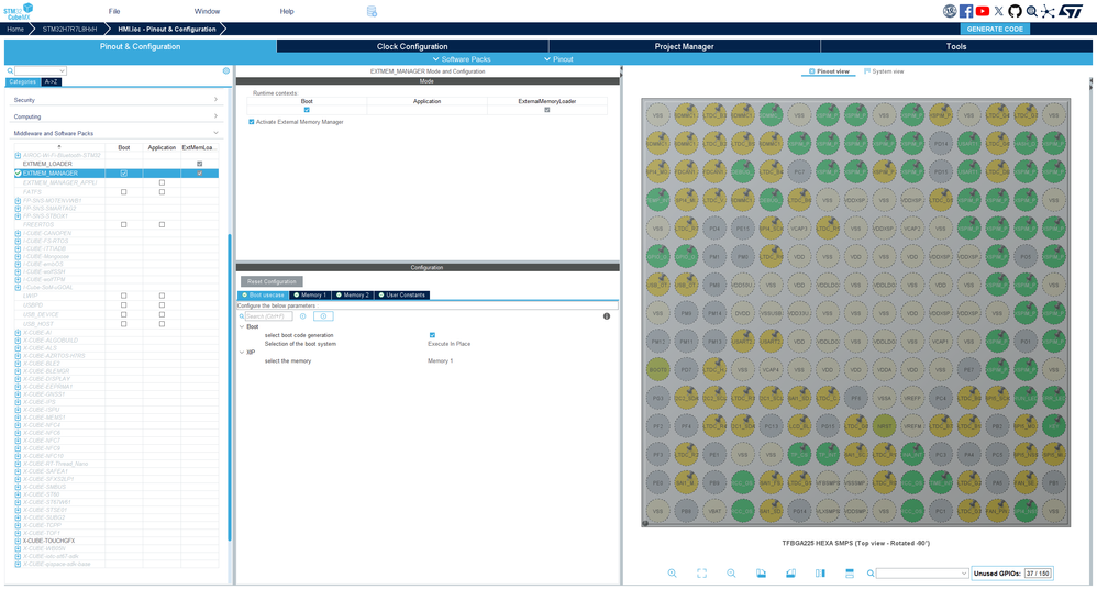

STM32H7R7L8H6H XSPI2 is mounted with MX25UM25645GXDI00, and the frequency setting exceeds 133Mhz. The Boot program fails to run and gets stuck in the "XSPI_WaitFlagStateUntilTimeout" function.
Please help me!XSPI2 ConfigurationXSPI2 ConfigurationClock Tree ConfigurationClock Tree ConfigurationEXTMEM_MANAGER Config 1EXTMEM_MANAGER Config 1EXTMEM_MANAGER Config 2EXTMEM_MANAGER Config 2Stuck hereStuck here
g_da01
The issue has been resolved. Simply open HSLV in STM32CubeProgrammer and enable the high-speed mode1.png
