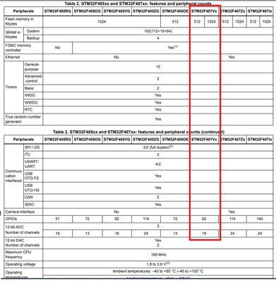

what the difference between STM32F407VET6 and STM32F407VGT6
Karuniawan_Amah
I have buy STM32F407VET6 discovery in the past, and for some reason i need some more. been looking on the local marketlist on my country most don't sell it anymore, and my past store still hasn't restocking it yet, and i'm found similar board with same layout but the part number are STM32F407VGT. can anyone tell me the difference of both? well from pinouts and pinout capabilities such as I2C, Interrupt etc.
mƎALLEm
STM32F407VET
STM32F407VGT
The only difference is the Flash memory size:
E: 512kB
G: 1024kB
Refer to the datasheet:
E: 512kB
G: 1024kB
Thanks for fast reply appreciate it. maybe this is too much to ask, just to make sure. can the VGT replace the VET one without any problem? from your reply before i see the only difference is only on the flash memory and both are have same capabilities on anything else. i'm working on a project and i'm told to buy exactly that, VET one that is. but as i can't find it i want to replace it with the VGT one? are it's okay? and won't have any problem to interchange between both? so much thanks
There is no differences except the Flash memory size.
Since VGT has more Flash than VET, VGT can replace VET without any issue.
