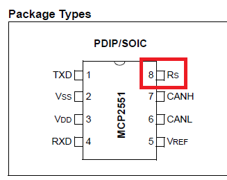

What about Rs pin voltage level? How did you connect that tranceiver's pin? this pin is to put the tranceiver in a stanby mode. So you can't send/receive anything on the bus.
So it should be at least tied it to the ground:
Read Rs section in the datasheet.

I have connected transreceiver like this. How can I connect Rs Pin to ground?

It seems they are a purchased modules. But anyway you need to:
- Check the Rs pin connection continuity: Pin 8 connected to the ground?

It needs to connect Rs to Ground for both the transreceiver??
And All the other point I have checked properly.
‎2024-04-12 2:40 AM
@mr_vineet wrote:I have connected transceiver like this. How can I connect Rs Pin to ground?
So you're using some 3rd-party module?
Then you need to check the schematic of that module.
