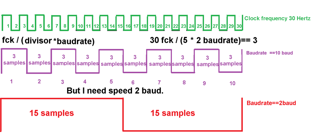

What is this value that is written to the USART_BRR register?
What is it for?
I don’t understand why the calculation is done using the formula: fclock / (the divisor, in my formula it is 5 * baudrate)0693W00000NskeHQAR.pngFor example, here is an example calculation:
I made the numbers much smaller to simplify the example.
fclock / (divisor, in my formula it is 5*baudrate)
fclock ==Clock frequency==30 Hertz.
Desired baudrate==2
Divisor == 5
30 fclock / 2 baud * 5 divisor==3 this number is written to the USART_BRR register.
3 what is this number?
What is it for?
BRR== Baud Rate Register. But 3 is not the baudrate I needed. I have 2 desired baudrate.
Or does it not matter what my desired data rate is?
Why would I then enter the desired baud rate if that's the case?
Does this formula calculate the speed that will be applied, and not the speed that I need?
Maybe this will be useful: Shown in the picture
If a marker is set every 3 bits at a clock frequency of 30 Hertz, based on these markers, we get a speed of 10 baud.
But I needed a speed of 2 baud, this formula: fclock / (divisor, in my formula it is 5 * baudrate) does not produce this calculation.

The BRR is NOT the baud rate
Baud Rate = APBxCLK / USARTx->BRR
Baud Rate =24,000,000 / 208
Baud Rate = 115384.62 ie 115200 +0.16%
BBR = 2500
24,000,000 / 2500
9600 baud

For 16x Oversampling Mode
BRR = APBxClock / Baud
Say USART1, on APB2, with a clock of 24 MHz
24,000,000 / 115,200 = 208.3333 -> 208
USARTDIV=fclock / (16*baud)
USARTDIV=24000000/(16*115200)==13
And what is this number 13?
In this case, the USART_BRR register will be written to the number 13 0
HEX:D0
Decimal: 208

And 208 is entered into the USART_BRR register because the last 4 bits of this register are for the fractional part.
Just such a form of recording in this register.
The actual baud rate is 13.02083
I think the number 16 in the formula is to combine the integer and fractional parts in one register.
This trick works only with the number 16.
I didn't manage to do it with other numbers.

That's an old problem with STM32 Reference Manuals. Just forget this "division by 16" and "fractional part" and everything becomes simple. For 16x oversampling (default), the value in BRR should be the properly rounded result of dividing the UART input clock by the baud rate. That's it. No "fractions", no "div by 16".
It is almost the same in 8x oversampling mode. The only difference is bit 3 of BRR is not used and the result of division is written to bits 15..4 and 2..0.
