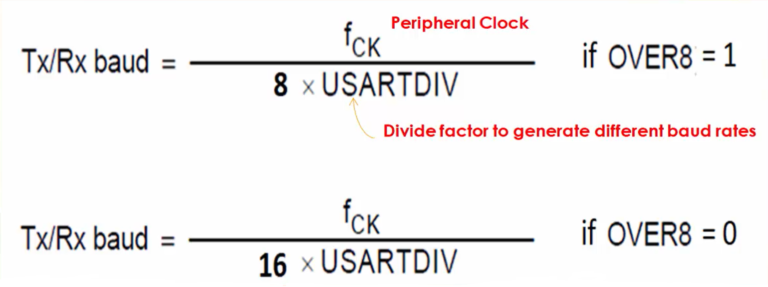

What is written to the USART_BRR register?
MMust.5
Senior II
What is this value that is written to the USART_BRR register?
What is it for?
I don’t understand why the calculation is done using the formula: fclock / (the divisor, in my formula it is 5 * baudrate)0693W00000NskeHQAR.pngFor example, here is an example calculation:

115200 is the baud rate; UART_CLOCK / BAUD _RATE (correctly rounded) is the value written to BRR register. BRR is a baud rate divisor register. That's it. Forget "mantissa" and "fraction". UART input clock divided by BRR content gives the baud rate.

The 16x over-sampling matches well with the 4-bit fractional model
The BRR is NOT the baud rate
Baud Rate = APBxCLK / USARTx->BRR
Baud Rate =24,000,000 / 208
Baud Rate = 115384.62 ie 115200 +0.16%
BBR = 2500
24,000,000 / 2500
9600 baud
Consider the oversampling, which normally is 16. 13*16 = 208

This formula contradicts what you wrote:
0693W00000NsnGSQAZ.pngUSARTDIV is not 208.
USARTDIV is 13.
This is the correct formula:
24000000/16*115200==13
208 decimal form of the HEX number that is stored in the BRR register: D0
D==13
0==this is the fractional part of USARTDIV equal to zero.

208 will be in the BRR register both at sampling 8 and at sampling 16, but this does not mean that you must always divide by 208:
24000000/208 is wrong to always divide by 208, first you need to find out what discretization will be.
First you need to find the USARTDIV divisor.
This is done like this:
24000000/16*115200==13 For baud rate 115200.
The bit rate at sampling 8 will be 230,400
24000000/13*8==230400
This is how the divisor is calculated for a rate of 230,400 and a sampling rate of 8:
24000000/8*230 400=13
That is, the USARTDIV divisor is the same in both cases.
The number 208 is not 208.
This is D0 in HEX
It's 13
13 is the number to be multiplied by the desired discretization: 8 or 16
So I think it's clearer.
I thought and still I don’t understand why the formula uses division by 16.
fclock / (16*baudrate)
Everything that follows is clear, but why division by 16 is used in the formula is not clear.
Seems to understand.
So it is very convenient to find the desired divisor.
As I described above.
If there were no division by 16 in the formula, then the number 208 would be written into the BRR register.
And how now to find the divisor for sampling 8? 208/2? Illogical calculation.
13*16
13*8
So much clearer.
