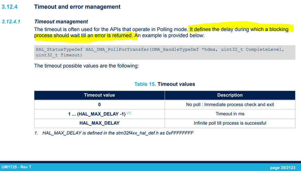

I want to understand the Timeout parameter of the HAL_SPI_Transmit, HAL_SPI_Receive and HAL_SPI_TransmitReceive function.

I advise your to check the user manual "Description of STM32XXxx HAL driver" (as this User manual), to have an overview of the HAL drivers with the configuration of the functions, and how to use the given API.

Sorry ST Employee, but i dont see here any info about timeout...
Then for MASTER SPI is timeout only for peripheral is busy from previous oper.
Or Chrizzly and i may ask crash timeout communication when i use lower time as needed to real transfer data?
For SLAVE SPI timeout is for wait to master ? Or plus data time ??? USW.

I cannot figure out how can transmit on master in blocking mode timeout ?!
  • Master is handling CS
  • Master is handling Clock
  • Master is writing to MOSI and reading from MISO
So even if slave does not exist, is not attached the transmit must go through and transmitreceive will go through and some garbage will be read (from floating pins) but I do not see how a timeout can happen here?
I can not understand this too, and I found my code just stuck there for noreason.I can't understand why a master SPI would have a timeout.
I figured it out, on my setup the $@#^#()%$&^ who made the PCB didn't properly connect all the power pins, and power for the USB module was also powering one of the SPI modules so since we did not use USB he didn't connect power to that pin (even worse, he tied it to ground) so SPI module had no power and the software effect was "timeout" for that spi module. Cutting the trace on the board and tying pin to power solved the problem.
