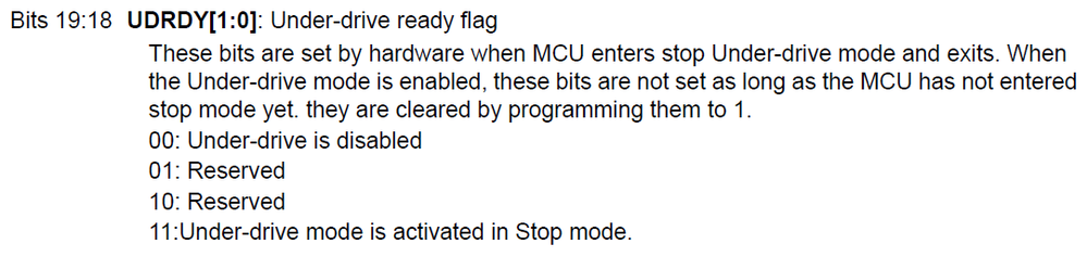

I'm not able to enable MR under-drive mode in my STM32F779NI chip.
The exact problem is UDRDY is not getting set -> Line number 39 to 43.
Below is the code snippet. Any suggestion would be very helpful. Thanks in advance.

‎2020-05-03 6:41 AM
It looks like UDRDY bits get set only when the CPU enters stop mode. You can check for and clear them after it wakes back up.

‎2020-05-03 6:53 AM
Sorry. I overlooked this information. Thanks a lot ! :)

‎2020-05-03 6:55 AM
But the HAL library for PWRex itself has a check wait loop for this flag field . But luckily with a timeout :grinning_face: .
